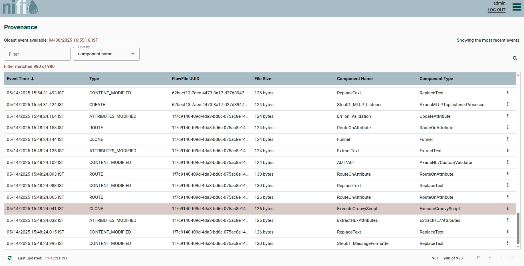

:clipboard::clipboard: Showing 1 recent provenance events:
:three_o_clock: 05/14/2025 15:48:24.041 IST
:wrench: Component: ExecuteGroovyScript (ExecuteGroovyScript)
:page_facing_up: Type: CLONE
🧾 UUID: 1f7c9140-f09d-4da3-bd6c-075ac8e1444b
:package: Size: 126 bytes bytes
but the issue here is it shows the end of the provenance data not the latest one. the below is my python script method :

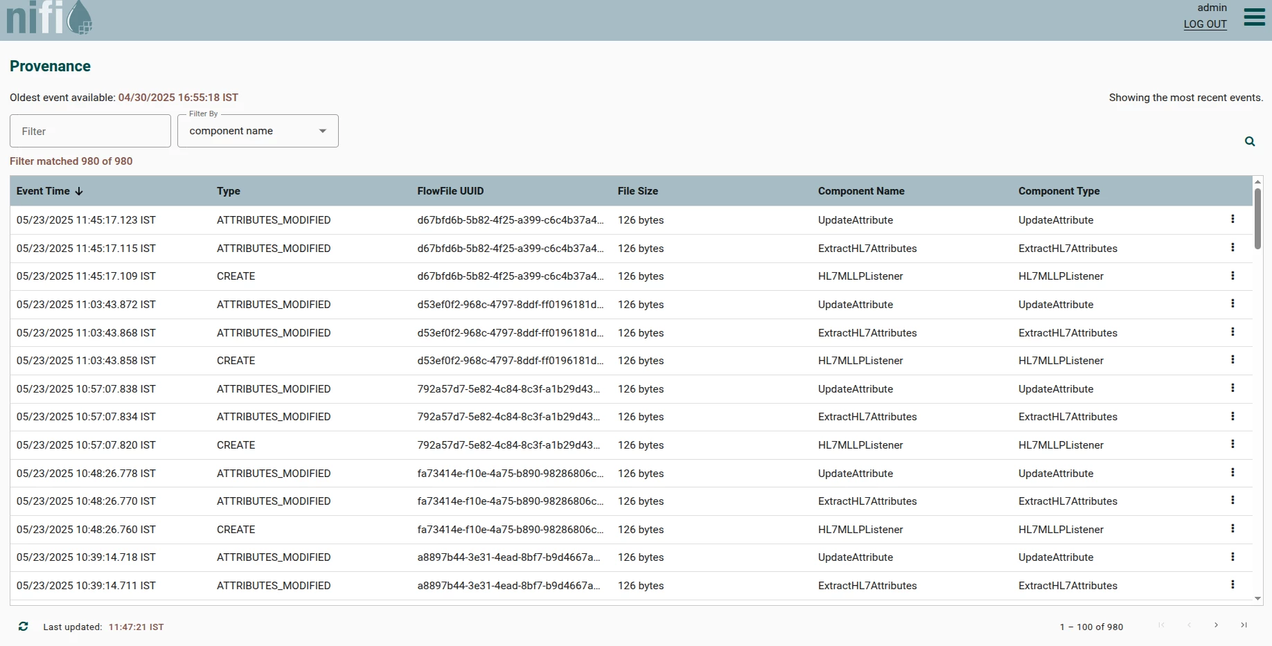

Here is my View Data Provenance (UI) the latest records shows on the top.AllIsWell_0-1747981128675.png
But it fetches the random data as attached UI screenshot of provenance data:
I tried with all combinations of reverse=False but no luck, if someone already tried and got the success result please let me know where I made the wrong or anything that i missed out here.
