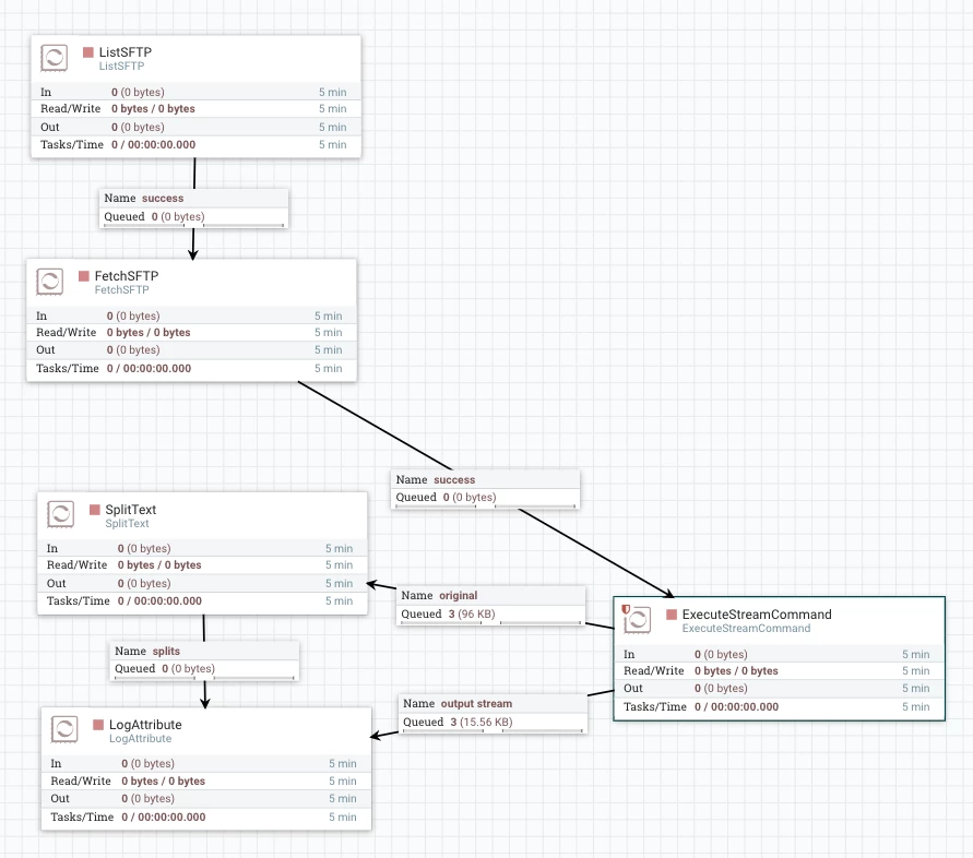

This simple flow shows how you could list the files, fetch them and then after they're fetched, use the results flow files to trigger the state being cleared in the ListSFTP processor:

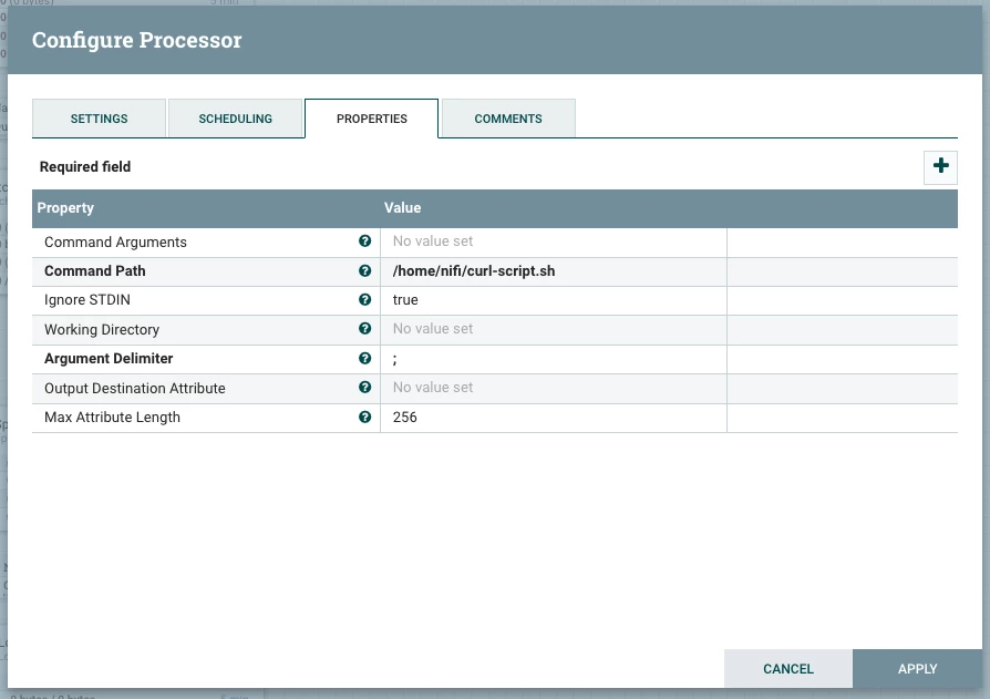

The configuration of the ExecuteStreamCommand processor looks like:
The contents of the curl-script.sh file, of course you would fill in the appropriate host and port for your environment as well as the uuid of the processor.

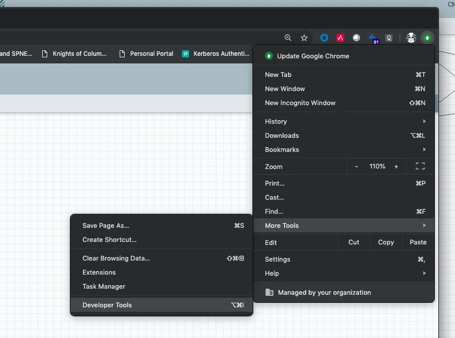

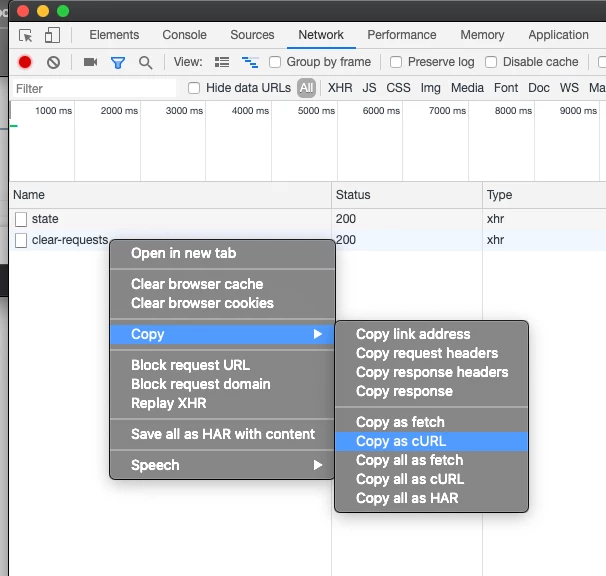

The curl command can be obtained by
Then using the Developer tool, get the curl command when you manually clear the state of the processor
