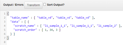

Hello everyone! I need a help in Jolt transform.

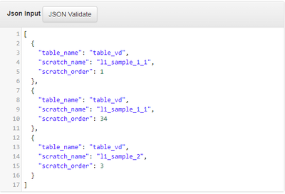

I have array, that consist from many json objects. (https://jolt-demo.appspot.com/ )
     "table_name": "table_vd",
     "scratch_name": "l1_sample_1_1",
     "scratch_order": 1
     "scratch_order": 34
     "scratch_name": "l1_sample_2",
     "scratch_order": 3
What transformation of Jolt needs to be done to get the following result?

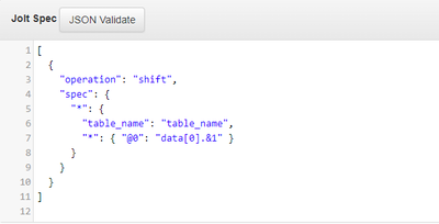

Now i have next Jolt construction.
     "operation": "shift",
     "spec": {
           "table_name": "table_name",
           "*": { "@0": "data[0].&1" }
But the result is not correct.

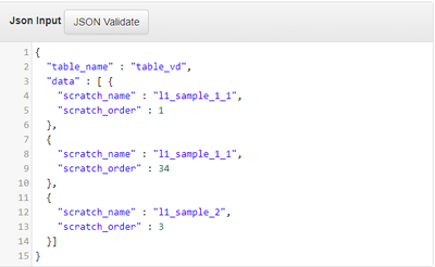

This task has been successfully solved! The required Jolt construction is shown below.
     "spec": {
         "table_name": "&",
         "*": "data[&1].&"
     "operation": "cardinality",
     "spec": {
       "table_name": "ONE"
