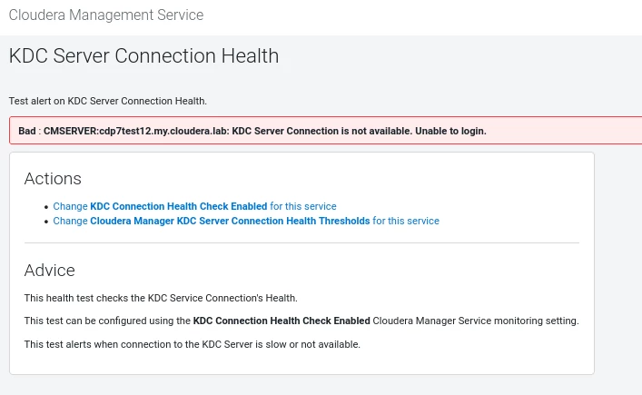

Hi all,

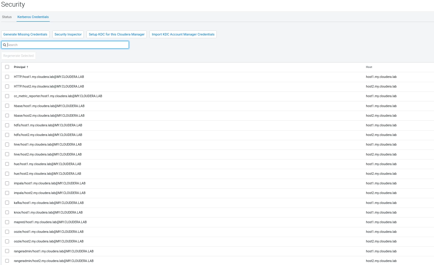

I have a cluster in CDP version 7.1.8 private cloud base. The Cloudera Management service show bad health and indicate that the connection to KDC server is not available.
I can regenerate missing credentials under Administration > Security > Kerberos Credentials
Moreover, I can do kinit in the CM server host. Therefore I have no idea why the connection shows failure.
Please let me know if I should provide further information. Thank you.

Created 05-03-2023 12:06 AM
From the system log, I found error saying unsupported Keytype. I am using OpenJDK 8u332.
Do anyone know how to solve this? Thank you.

Created 01-25-2024 05:17 PM
I am seeing the same issue and cant seem to find a way around it on Private Cloud Base 7.1.9 with AD based kerberos.
JAVA SE jdk11 and krb5.conf is set according to https://docs.cloudera.com/cdp-private-cloud-base/7.1.8/security-kerberos-authentication/topics/cm-se...
CMSERVER:<fqdn>: KDC Server Connection is not available. Unable to login.
Appreciate any help I can get to resolve this error.
Thank you!
Created 01-26-2024 09:12 AM
Can you share the exact error you notice in CM server log around the timeframe in which you notice the error 'CMSERVER:<fqdn>: KDC Server Connection is not available. Unable to login.', the full exception from cm server log will help to understand the issue better.
