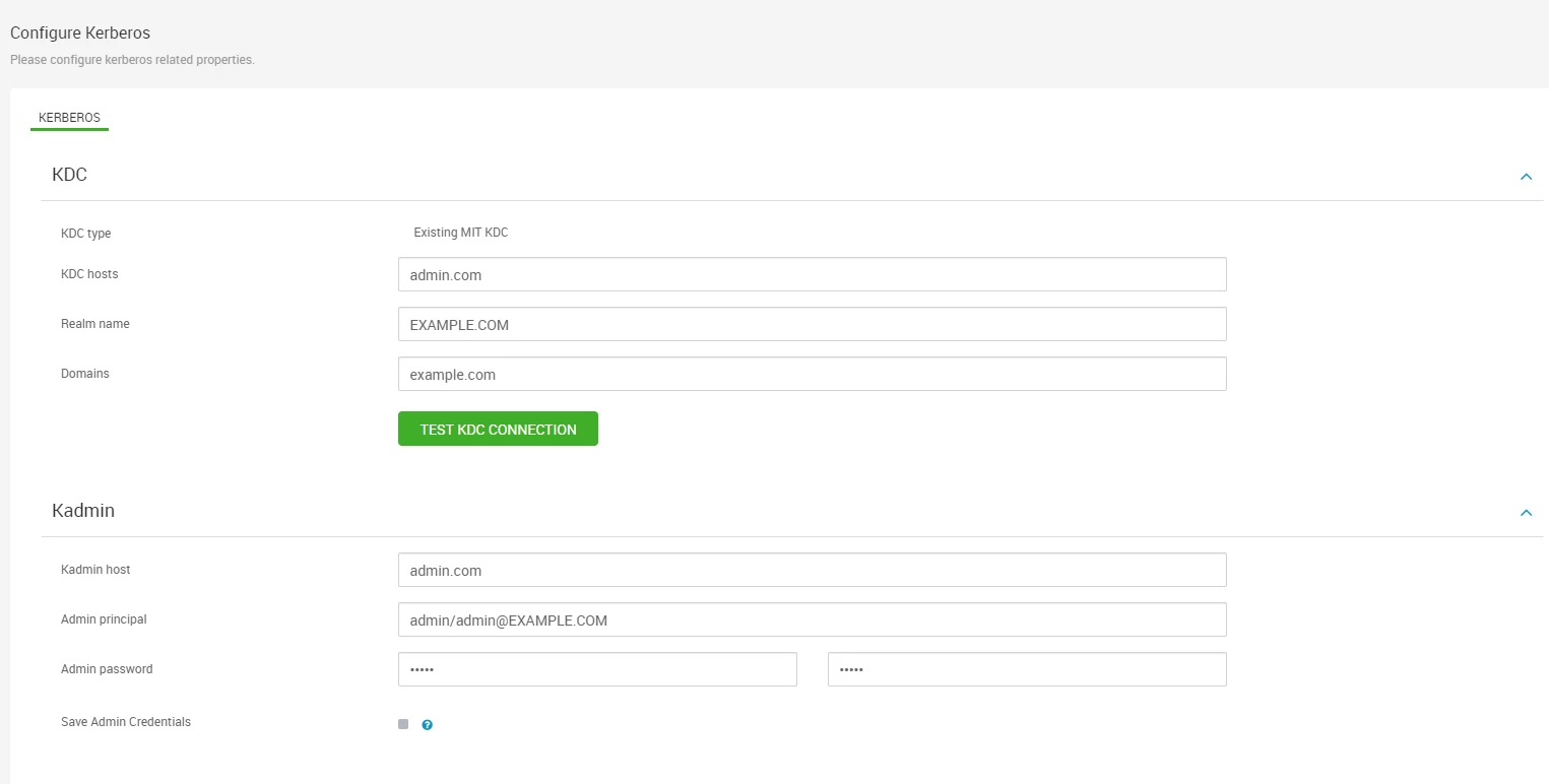

Hi Everyone,

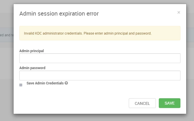

While kerberizing my cluster using MIT-KDC and Ambari Kerberos Wizard. I am facing the following window popup at the time of Testing client after client installation saying :
I'm using ambari 2.7.8
HDFS 3.3.6
UBUNTU 22
config of krb5.conf

:KERBEROS_SERVICE_CHECK, inputs :{HAS_RESOURCE_FILTERS=true}, resourceFilters: [RequestResourceFilter{serviceName='KERBEROS', componentName='null', hostNames=[]}], exclusive: false, clusterName :hadoop
2024-05-30 05:12:20,298 WARN [ambari-client-thread-108] KDCKerberosOperationHandler:329 - Failed to kinit as the KDC administrator user, admin/admin@EXAMPLE.COM:
ExitCode: 1
STDOUT:
STDERR: kinit: Server not found in Kerberos database while getting initial credentials
2024-05-30 05:12:20,299 ERROR [ambari-client-thread-108] KerberosHelperImpl:2507 - Cannot validate credentials: org.apache.ambari.server.serveraction.kerberos.KerberosAdminAuthenticationException: Invalid KDC administrator credentials.
The KDC administrator credentials must be set as a persisted or temporary credential resource.This may be done by issuing a POST (or PUT for updating) to the /api/v1/clusters/:clusterName/credentials/kdc.admin.credential API entry point with the following payload:
"Credential" : {
"principal" : "(PRINCIPAL)", "key" : "(PASSWORD)", "type" : "(persisted|temporary)"}
2024-05-30 05:12:20,299 ERROR [ambari-client-thread-108] CreateHandler:80 - Bad request received: Invalid KDC administrator credentials.
"Credential" : {

Hi @rizalt  The error below indicates that the configured KDC server does not have the admin/admin principal.
I can see that the admin and kdc server hostnames are set to admin.com from krb5.conf.
Could you verify that the hostnames for the admin and kdc servers are correct? Also check hostname  admin.com is resolving correctly from the client host

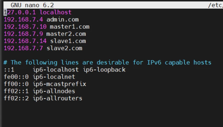

@Scharan  My Hostname in my kdc server
*** System restart required ***
Last login: Thu May 30 07:23:57 2024 from 192.168.7.211
root@admin:~# hostname
admin.com
root@admin:~#
in my client host
root@slave2:~# ping admin.com
PING admin.com (192.168.7.4) 56(84) bytes of data.
64 bytes from admin.com (192.168.7.4): icmp_seq=1 ttl=64 time=0.608 ms
64 bytes from admin.com (192.168.7.4): icmp_seq=2 ttl=64 time=0.669 ms
64 bytes from admin.com (192.168.7.4): icmp_seq=3 ttl=64 time=0.561 ms
64 bytes from admin.com (192.168.7.4): icmp_seq=4 ttl=64 time=1.94 ms
