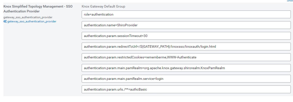

Knox-sso looks as following (the default one)

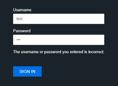

I created a user named - test with a password. I tried to access the Knox Gateway UI but I get the issue.
The Knox Gateway log says:
(KnoxPamRealm.java:handleAuthFailure(170)) - Shiro unable to login: null
Note: I am using CDP 7.1.6 and I can login to my host (where Knox Gateway is installed) using the test user. Also, there's no Kerberos setup.
Please share if there's something that needs to be adjusted.
