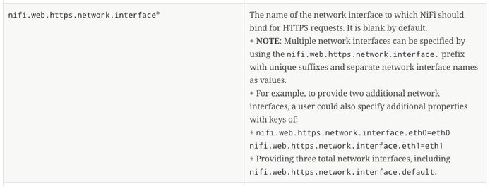

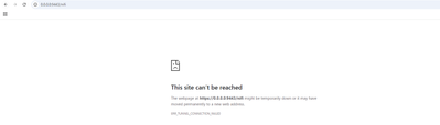

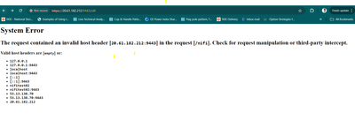

We have configured the nifi  two nodes cluster on Azure environment with the below nifi properties, we are using private ip address of NIFI, currently the NIFI application is running on ubuntu system without any error, But could not able to access it from web url, can you please guide us what are the steps we need to follow in order to access these from web uRL.
we tried through load balancer, The problem in the load balancer is that we are not able to get the Vm's traffic to reach the load balancer.
Also followed the configuration steps from the below blog

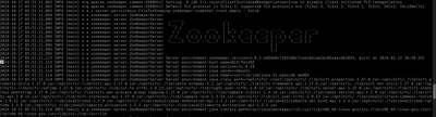

# Specifies whether or not this instance of NiFi should run an embedded ZooKeeper server
nifi.state.management.embedded.zookeeper.start=true
# Properties file that provides the ZooKeeper properties to use if <nifi.state.management.embedded.zookeeper.start> is set to true
nifi.state.management.embedded.zookeeper.properties=./conf/zookeeper.properties

nifi.web.http.host=
nifi.web.http.port=
nifi.web.http.network.interface.default=
#nifi.web.https.host=NiFiTest01
nifi.web.https.host=0.0.0.0
#nifi.web.https.port=9443
nifi.web.https.network.interface.default=
nifi.web.https.application.protocols=http/1.1

nifi.web.proxy.context.path=
nifi.web.proxy.host=

Attaching the nifi logs which is running
web url unable to access by using private ip address which was given  0.0.0.0.0
Request you to kindly check and update me.

NiFi offers a specific configuration property if you want to define multiple network interfaces you want NiFi to listen for connections on.
127.0.0.1 is the loopback address (localhost), which if used in NiFi, means NiFi is only listening on that loopback address.
So you should be configuring your "nifi.web.https.host" property for the hostname of the server on which it is running.  This hostname would need to be resolvable and reachable by your browser.

I see you are using the embedded zookeeper (ZK).  ZK requires quorum in order to be useable.  With only 2 nodes, you only have 2 ZK nodes which is not a quorum.  IF either one of the nodes becomes unreachable or goes down, you will not be able to access the one remaining node either since ZK has lost quorum.   Quorum consists of an odd number of ZK nodes (typically 3 or 5) depending on how much loss tolerance you want to have.   While embedded ZK makes things easy with setup, you'll want to have at least 3 NiFi nodes (this allows you to lose up to one node and still retain access to the NiFi UI of the other 2 nodes.  Of course using an external ZK is even better and the best production option as stopping/starting or loss of NiFi nodes has no impact on quorum.
These are the areas to address first.

nifi.web.https.host has been modified as per your instructed., provided the private ip address of the vm
nifi.web.https.host=53.13.138.69 #private ip of azure vm
nifi.web.jetty.working.directory=./work/jetty
nifi.web.jetty.threads=200
nifi.web.max.header.size=16 KB
nifi.web.proxy.host=20.61.182.212 # load balancer public ip of Azure

# zookeeper properties, used for cluster management #
nifi.zookeeper.connect.string=NiFiTest01:2181,NiFiTest02:2181
nifi.zookeeper.connect.timeout=10 secs
nifi.zookeeper.session.timeout=10 secs
nifi.zookeeper.root.node=/nifi
nifi.zookeeper.client.secure=false

Sounds like you may have gotten past your original issue after following the guidance I provided already?  You new questions don't seem directly related to the original query.
The invalid host header can be resolved by modifying the nifi.web.proxy.host property in the nifi.properties file:
nifi.web.proxy.host=20.61.182.212,20.61.182.212:9443
Or by including additional entry(s) in your certificates SAN list.

  • With certificate based mutual Auth there is no login required.
3. "nifi.security.user.login.identity.provider=singleUser" is not a valid configuration. I assume you meant "nifi.security.user.login.identity.provider=single-user-provider.
  • With "Single-user-provider" configured, the only username and password accepted would be for the single user credentials Nifi auto-generated and output to the logs the first time NiFi was started with that provider configured.
  • If you have no intention of using the single-user-provider, just leave "nifi.security.user.login.identity.provider=" unset.
4. you don't need to worry about sticky sessions if you are only using certificate based authentication, since your client certificate would be passed in every request and their are no tokens involved like in login based providers.
  • If you did decide to use a login-provider like LDAP or Kerberos later, sticky sessions would need to be setup first or you may never be able to access the UI.  Once you enter the username and password, the next request goes is to access UI using that token and if the load balancer were to redirect that to a different node, the UI would not load but instead throw and exception about the unknown user.
