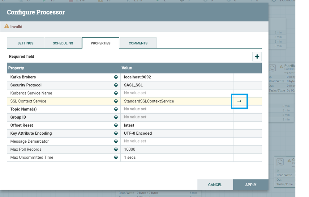

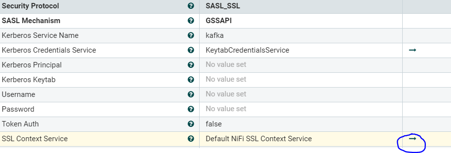

I assume that you are using ConsumeKafka OR ConsumeKafka2.0 version NiFi processor ,when you select option in SSL Context Service as StandardSSLContextService then you have to select right arrow as indicated below image .

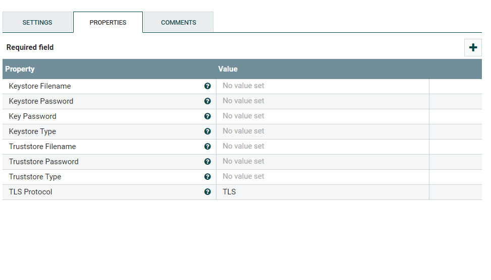

Properties of StandardSSLContextService will be prompted to you and you can enter the values of the properties Keystore Filename,Keystore Password,Key Password,Truststore Filename,Truststore Type. etc.
After providing the values of the SSL properties , enable the Controller Service and start running the ConsumeKafka processor.

Even this is old thread updating .
add
java-home/bin/keytool -genkey -alias server-alias -keyalg RSA -keypass changeit
-storepass changeit -keystore keystore.jks
java-home/bin/keytool -export -alias server-alias -storepass changeit
-file server.cer -keystore keystore.jks
This need to be configured on NiFI instance.
