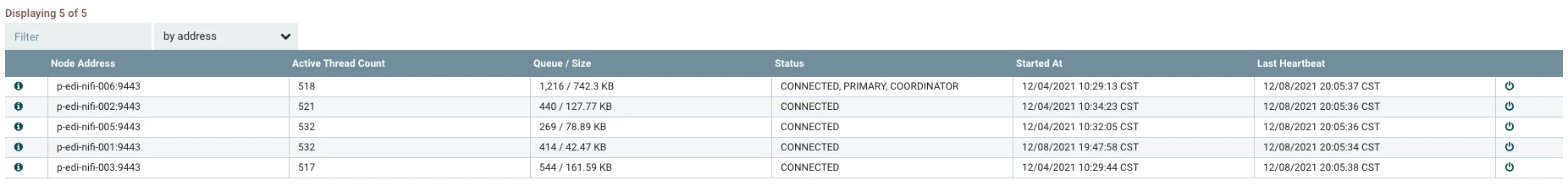

now all nodes have the same issue and after running a day , some nodes will disconnect from cluster, I upload node 2 and node 3's dump file and nifi-app.log, who can help me locate the cause, thanks in advance.
the primary and coordinate node is p-edi-nifi-003:9443

dupuy_gregory
Gold ⭐️
December 20, 2021
Hi ZhouJun,
Have you find a solution to your issue ?
I have the problem in my production and staging environnement since few months without any solutions. Network issue maybe ?
Thanks for your feedback
Translate
lhoss_Ansiblize
Silver ⭐️
August 2, 2022
The issue above, specifically also containing error:
java.lang.RuntimeException: Cannot create negative queue size
seems to have been solved in Nifi v15.1 or v16!
See [NIFI-9433] Load Balanced Connections hangs / log "Cannot create negative queue size" - ASF JIRA (apache.org)
Myself, I  have an issue in the same high-level error "ConnectionLoadBalanceServer Failed to communicate with Peer node" , but a different (root)cause ( which I'm not sure yet how it is  caused , but must be related to network, our docker-swarm multi-node deployment OR a resource bottleneck):
... ERROR [Load-Balanced Client Thread-7] o.a.n.c.q.c.c.a.n.NioAsyncLoadBalanceClient Failed to communicate with Peer nifi2:8443
java.net.SocketTimeoutException: Timed out waiting for Peer nifi2:8443
Translate
MattWho
Titanium ⭐️⭐️⭐️
Titanium ⭐️⭐️⭐️
August 2, 2022
@ZhouJun
I'd recommend upgrading your NiFi to the latest release as you may be hitting these related bugs:
https://issues.apache.org/jira/browse/NIFI-9835
https://issues.apache.org/jira/browse/NIFI-9433
https://issues.apache.org/jira/browse/NIFI-9761
Thank you,
Matt
Translate
