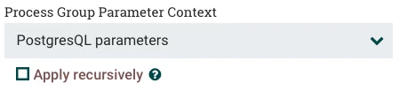

What you describe here sounds like the exact use case for using NiFi's parameter contexts.  Parameters can be used in any NiFi component property.  They make it easy to build a dataflow in your dev environment and then move that dataflow to test or prod environments that have the same parameter contexts but with different values.  This even works when using a shared NiFi-Registry to version control your ready dataflows for another environment.
Lets say you create a "Parameter Context" and associate that created parameter context with a Process Group(s). Now you can configure a property in a processor for example and click on "convert to parameter" icon to convert that value into a parameter within yoru parameter context.
Lets say you create a Parameter context with name "PostgresQL parameters".
Then you can configure your Process Group (PG) to use that parameter context:
Now you can configure/convert your component properties that are unique per NiFi deployment environment to using a parameter.
Let's say you are ready to move that flow to another environment like prod.  So you version control that PG on dev to NiFi-Registry.  Then on Prod you connect to that same NiFi-Registry and import that dataflow.  When that flow is loaded in Prod, if a parameter context with the exact same name "PostgresQL parameters" already exists, that imported flow will use that parameter context's values.  This eliminates the need to manage these configuration all over the place in yoru dataflows.   You can also open your parameter context and edit a values and NiFi will take care of stopping and starting all the affected components.
