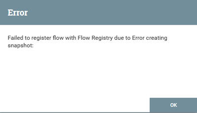

Hello ,
After importing flows from my Registry in Nifi , while I try to commit Local changes , I get this below error:
The logs for Nifi show the following :
Caused by: org.apache.nifi.registry.flow.FlowRegistryException: Error creating snapshot:

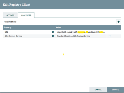

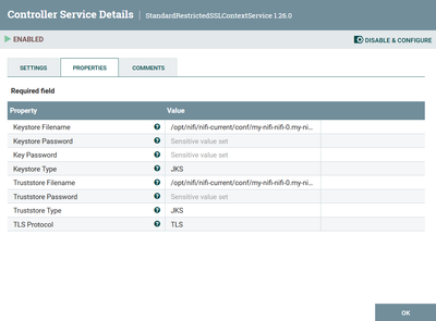

Reviewing all your configuration files is not the first step here. I suspect your MutualTLS exchange between your NiFi and NiFi-Registry is not successful resulting in that connection resulting as "anonymous" user.  (the user you see in the NIFi-Registry UI in upper right corner before you click login to access as a different authenticated user.
Put the following class in DEBUG on your NiFi-Registry via the logback.xml:org.apache.nifi.registry.web.security.authentication
Start tailing the nifi-registry-app.log
You'll start seeing some DEBUG log lines (will be noisy)
Then attempt to start version control on some process group in NiFi which will open the version control UI n NiFi.
In the nifi-registry-app.log at that moment in time you will see one of two things:
2025-04-10 13:54:53,360 DEBUG org.apache.nifi.registry.web.security.authentication.IdentityFilter: Attempting to extract user credentials using X509IdentityProvider
2025-04-10 13:54:53,361 DEBUG org.apache.nifi.registry.web.security.authentication.IdentityFilter: Adding credentials claim to SecurityContext to be authenticated. Credentials extracted by X509IdentityProvider: AuthenticationRequest{username='<NIFI certificate DN>', credentials=[PROTECTED], details=org.apache.nifi.registry.web.security.authentication.x509.X509AuthenticationRequestDetails@713e0007}
above tells you NiFi presented a trusted and clientAuth certificate at you will see that certificate's DN. In this case make sure that DN exists as a user in NiFi-Registry (case sensitive) and give that user read on "Can manage Buckets" and read, write, delete on "Can proxy user requests".
or you'll see....
2025-04-10 14:01:24,162 DEBUG org.apache.nifi.registry.web.security.authentication.IdentityFilter: Attempting to extract user credentials using X509IdentityProvider
2025-04-10 14:01:24,162 DEBUG org.apache.nifi.registry.web.security.authentication.x509.X509CertificateExtractor: No client certificate found in request.
2025-04-10 14:01:24,162 DEBUG org.apache.nifi.registry.web.security.authentication.IdentityFilter: Attempting to extract user credentials using JwtIdentityProvider
2025-04-10 14:01:24,163 DEBUG org.apache.nifi.registry.web.security.authentication.AnonymousIdentityFilter: Set SecurityContextHolder to anonymous SecurityContext
Above tells you the mutualTLS exchange was not successful and the connection was established as the "anonymous" user.  In this case you need to address your certificate issue so that mutualTLS can be successful.

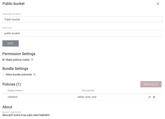

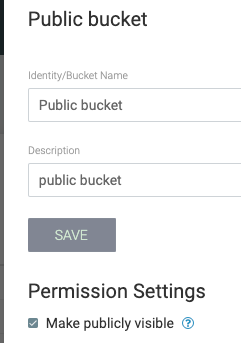

The bucket I have is publicly visible :
and I am still not able to make any commits to it .

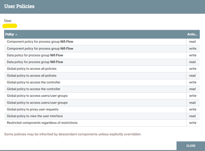

The user that I am logged in with in my Nifi Registry also has these privliges :
and I am not sure why I still can't make any changes or commits.
and here are the permissions for the same user for Nifi
Could you please help me identify what exactly I might be missing ?

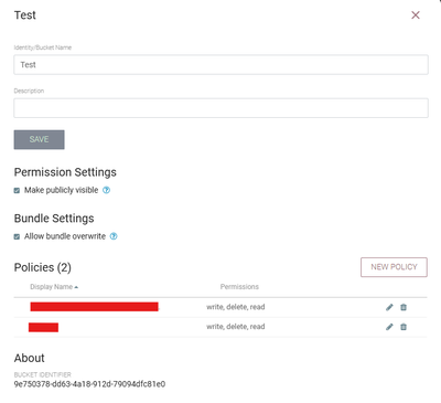

Master Mentor
@sha257
Your bucket having "Make Publicly Visible" checked is why you can load flows from this bucket on to your NiFi canvas.

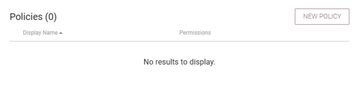

I see from that same screenshot you have not defined any policies on that bucket yet:

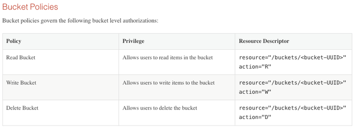

Refer to NiFi-Registry Access Policies to understand more about the policies setup on buckets and globally within NiFi-Registry.
The fact that this bucket is marked as publicly visible ONLY gives all users/clients "READ".  So your user is still not allowed to Write to the bucket which would be required to commit a new version of a flow which you are trying to do.
I also see that you gave your user all the global Special Privilege Polices.  A NiFi user would never "Proxy Requests".  The NiFi nodes/instances themselves will proxy requests to NiFi-Registry on-behalf of the NiFi user identity authenticated in NiFi that is attempting to facilitate any version control action in NiFi directed at this NiFi-Registry client.  So make sure your NiFi nodes are properly added to "Can proxy Requests" Special Privilege Policy.

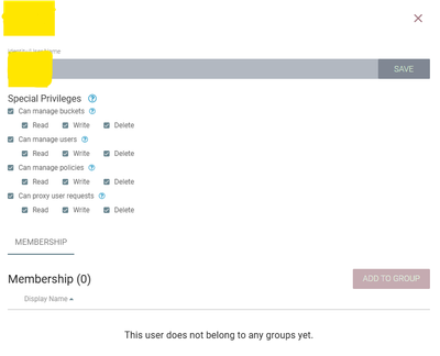

Hello @MattWho ,
Here are some changes and details that I would like to mention after your above answer.
1.
In this screenshot , the second user is the user that I am logged in as - let's say the user is abc123.
and I do see in my authorizations.xml that this user has the correct permissions assigned to the bucket policy :

Hello @MattWho ,
I have the StandardSSLContext Service defined as mentioned and I am unable to pinpoint where exactly I might be lacking the setup .

NiFi will attempt connect to NiFi-Registry using the NifiRegistryFlowRegistryClient setup in NiFi.   The NifiRegistryFlowRegistryClient has two configuration properties:
The URL is set to "https://<NiFi-Registry Hostname>:<NiFi-Registry-port>/"
The SSL Context Service if NOT set will use the keystore and truststore setup in the nifi.properties file.  The keystore and truststore used (whethere defined via an SSL Context Service or  using those from nifi.properties file MUST be capable of successfully negotiating a MutualTLS exchange between the NifiRegistryFlowRegistryClient and NiFi-Registry.   This means the ClientAuth Private key in the keystore must be trusted by the truststore configured in NiFi-Registry.properties file. This also means the ClientAuth PrivateKey entry in the NiFi-Registtry keystore file must be trusted by the truststore in the NifiRegistryFlowRegistryClient.  If this mutualTS exchange is not successful, the connection with your NiFi-Registry will be as the "anonymous" user identity.
You could use the output from openssl to see if mutualTLS connection would be possible by looking at output from both below:
openssl s_client -connect <nifi-registry-hostname>:<nifi-regsitry-port> -showcerts
openssl s_client -connect <nifi-hostname>:<nifi-port> -showcerts
Above assume your NifiRegistryFlowRegistryClient is using the same keystore and truststored used in the nifi.properties file.
Alternatively,  you could get the verbose listing from your  NifiRegistryFlowRegistryClient configured keystore and trustore and compare those with the openssl output from NiFi-Registry to validate if a mutualTLS connection is possible.
Assuming above is all good, then you need to verify proper authorizations are setup to allow the NifiRegistryFlowRegistryClient client identity (derived from the privateKeyEntry DN from the NifiRegistryFlowRegistryClient keystore) has the proper authorizations setup in NiFi-Registry.
The NifiRegistryFlowRegistryClient keystore PrivateKey DN must eb authorized in NiFi-Registry for the following policies:
"Can Manage buckets"  (Read)
"Can proxy user requests" (Read, Write, Delete)
Above allows the NifiRegistryFlowRegistryClient to be able to see all the NiFi-Registry buckets and to make Read, Write, or Delete request on behalf of the user identity (user string shown in upper right corner of NiFi Ui) authenticated in NiFi.
Once above is all good, we move on to what permissions the NiFi user that is being proxied needs in NiFi-Registry.
The user identity need to be authorized on each bucket from which or two which flow definitions will be read or written.
Here is a Sample public bucket ("Make publicly Visible" is checked):
Since this bucket as "Make publicly Visible" checked, any user identity and anonymous users can read all flow definitions added to this bucket (This is what allowed you to import a flow definition from your public bucket to your NiFi canvas).
You'll also notice that I have authorized by "nifiadmin" user identity read, write, delete on this bucket.  This allows my "nifiadmin" user identity to add or update (write) flow definitions into this bucket and delete flow definitions from this bucket.
From what you shared via the authorizations.xml, you have authorized "abc123" user identity read, write, delete on your public bucket.  So only thing to verify here is that "abc123" user identity is the exact same case sensitive user identity being displayed in the upper right corner of your NiFi UI when you are authenticated into your NiFi.  If they don't match then they are treated as different users.  It is the user identity shown in your NiFi that is being proxied and needs to be properly authorized in NiFi-Registry as above example.  (I know "abc123" is an example, but you get the idea here).

Registry Clients from Nifi :
SSL context service activated :
Updated Nifi Registry users.xml
<?xml version="1.0" encoding="UTF-8" standalone="yes"?>
<tenants>
    <groups/>
    <users>
        <user identifier="63542e71-d360-309e-bbca-29a1f8484f71" identity="CN=my-nifi-0.my-nifi-headless.nifi-server.svc.cluster.local, OU=NIFI"/>
        <user identifier="c22273fa-7ed3-38a9-8994-3ed5fea5d234" identity="CN=localhost, OU=NIFI"/>
        <user identifier="71b266f5-7764-3ff5-a812-80112278b50c" identity="abc123"/>
        <user identifier="702372cd-05d0-3378-98eb-2c263cb0dbb7" identity="CN=DEF456,OU=Service Users,OU=User Accounts,DC=corp1,DC=ad1,DC=xyz,DC=net"/>
    </users>
</tenants>
Updated Nifi Registry authorizations.xml
<authorizations>
    <policies>
        <policy identifier="ac587f43-6e1c-3890-81fd-83b4df2e678e" resource="/swagger" action="D">
            <user identifier="71b266f5-7764-3ff5-a812-80112278b50c"/>
        </policy>
        <policy identifier="d59a54f7-6dd6-34ad-a279-a26ffdb9eef8" resource="/proxy" action="R">
            <user identifier="63542e71-d360-309e-bbca-29a1f8484f71"/>
            <user identifier="2f62b1f7-e822-3d04-b041-b21b3327fc05"/>
            <user identifier="1f645d41-2d46-37fc-83a1-adce75c00913"/>
            <user identifier="c22273fa-7ed3-38a9-8994-3ed5fea5d234"/>
        </policy>
        <policy identifier="9d182b11-ebe3-3a7a-8731-98ce6d6e44fd" resource="/buckets" action="R">
        </policy>
        <policy identifier="dfbf3c51-fdec-3328-b169-3b54eb033147" resource="/buckets" action="W">
        </policy>
        <policy identifier="0eaa47b9-e409-304e-8682-30d1b0d86d05" resource="/swagger" action="R">
        </policy>
        <policy identifier="cf4d8390-5ac7-3ff0-82ce-a274b5f88b21" resource="/swagger" action="W">
        </policy>
        <policy identifier="627410be-1717-35b4-a06f-e9362b89e0b7" resource="/tenants" action="R">
        </policy>
        <policy identifier="15e4e0bd-cb28-34fd-8587-f8d15162cba5" resource="/tenants" action="W">
        </policy>
        <policy identifier="01b87cb5-c0b6-342d-b108-d8bc03ab5cde" resource="/policies" action="D">
        </policy>
        <policy identifier="2dbc92a2-b091-3616-8e88-5078b9103b04" resource="/tenants" action="D">

Bucket policy screenshot
The one redacted with yellow is user abc123
Thanks
