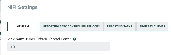

Is it possible that your entire "Max Timer Driven Thread pool" is consumed by other components on your canvas at times preventing this processor from being able to get a thread to run?

I can see the active thread in the top right corner of the processor which is hang forever. The max timer driven threads are not consumed, i will try to get the thread dump and see. I think i should contact provider of the processor (marklogic) as you suggested. Thank you.
