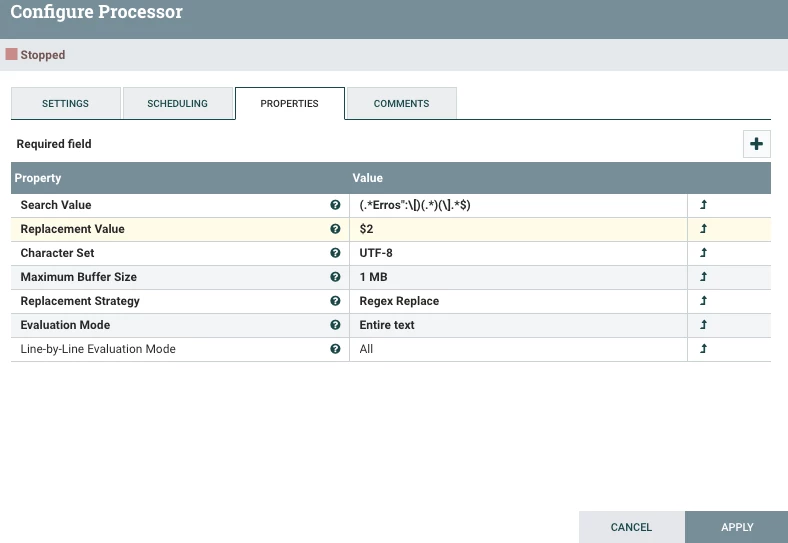

ReplaceText =
EvaluateJsonPath =
This is Response Before Replace Text =
{"RegistrosRecebidos":1,"RegistrosImportados":0,"Erros":["Erro registro 0: The statement has been terminated.\r\nString or binary data would be truncated in table \u0027Ober_HML.dbo.DB_WS_IMP_CLIENTE\u0027, column \u0027NOME_FANTASIA\u0027. Truncated value: \u0027ADLER PELZER PERNAMBUCO IND. E COMERCIO \u0027."]}
What I need is to take the value of the "Errors" property and save it in my database, only when trying to do this with EvaluateJsonPath it returns the following error:
For this reason I am trying to use ReplaceText but also without success.

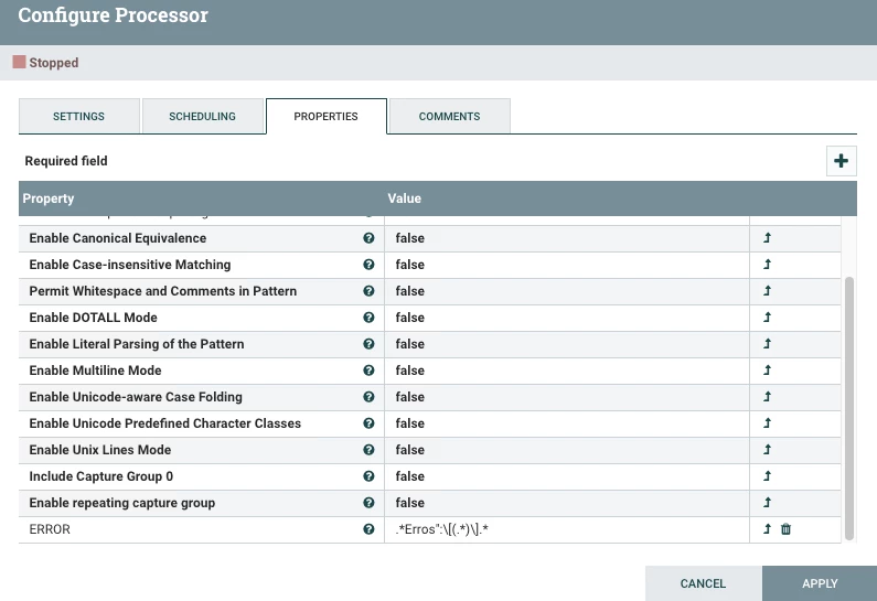

The "EvaluateJsonPath" processor you shared has the configured destination as a FlowFile-Attribute and thus leaves the content of the FlowFile unchanged.
So if FlowFile Attribute is where you want this parsed output to reside, you could use "ExtractText" [1] as an alternative solution.
The used value here would be:
.*Erros":\[(.*)\].*
This has only 1 capture group which is for the content you are trying to extract.  That content is then added to the FlowFile in a new FlowFile attribute based on the property name.
If you instead want to replace the content of your FlowFile with only the portion of the original content you are trying to extract, you could use the "ReplaceText" [2] processor.
The used Java regex "Search value" here would be:
(.*Erros":\[)(.*)(\].*$)
Which breaks source content into 3 capture groups so regex matches entire content and capture group 2 matches on the string output you are looking for.
So "Replacement Value" is simply set to "$2" so that entire content is replaced with just contents of capture group 2.
