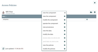

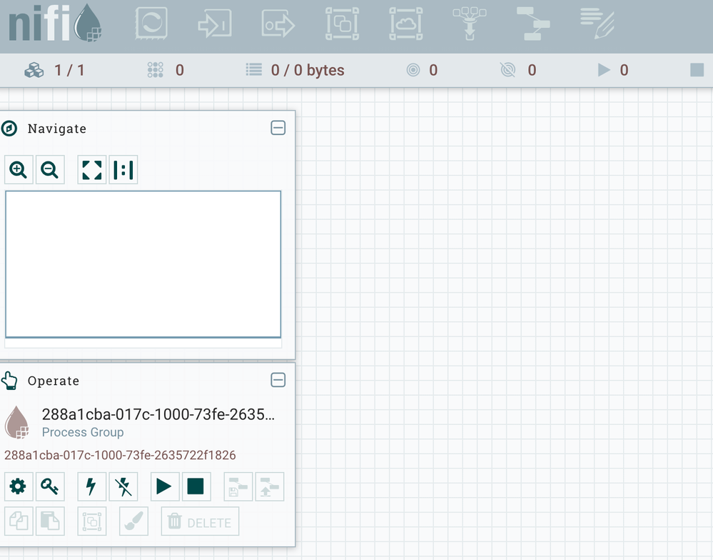

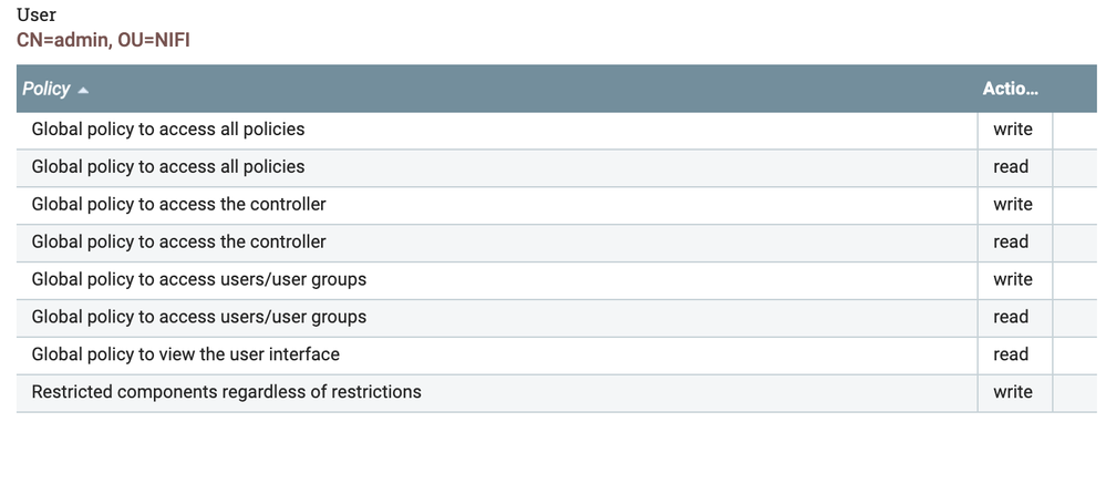

Anyways, I can view the UI using admin certificate created during setup, and when I visit the UI page I basically cannot use any of the buttons up top to create flows/etc.  I have attached pictures of my user policies and a picture of the top toolbar I'm talking about.  When I hover my mouse over any of the icons in the toolbar I get a circle with a line through it ('do not enter' sign).
I assume I need additional permissions, but I'm not sure what to add (I'm guessing it will be an addition to the authorizations.xml file).My admin user policiesMy admin user policiesButtons up top are all non-functional (ring with a line through it when hovering)Buttons up top are all non-functional (ring with a line through it when hovering)

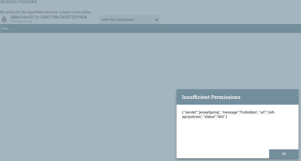

If I right click the canvas and attempt to give myself the permissions ('manage access policies'), there are no policies listed attempting to create one gives a 403 insufficient privileges error.

It is interesting that you are seeing a 403 in response to trying to add a new policy on the root Process Group (PG).
By granting your user string (CN=admin, OU=NIFI) to the following global policies:
you should have ability to set any additional policies anywhere.
From the root canvas you can either right click and select "manage access policies" or click on the small key icon in the "Operate" panel that shows the PG name and PG assigned uuid to access the PG level access policies.
First you would select the policy you want to add user or group strings to from the pull-down menu.
If the policy has not yet had any users assigned to it, you'll need to click on "add policy" before being able to click on the Then click on the small "add users/groups to this policy" icon to the far right.
Note: Child PGs added to the canvas will by default inherit all their policies from the parent PG. You will be given option to "override" this and set child specific users/groups on that child PG.
You are stating that you encounter a 403 when you click on the "add" button?
What do you see in the nifi-user.log when you perform that action?
If you found this response assisted with your query, please take a moment to login and click on "Accept as Solution" below this post.
Thank you,
Matt
Explorer
Thanks for your reply!
Yes I get a 403 insufficient privileges error when I try to create a new policy.
