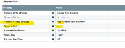

@cotopaul how can I set this schem in AvroWriter?
Translate
cotopaul
Platinum ⭐️
October 17, 2023
Open the Controller Service for AvroRecordSetWriter, and in the field Schema Access Strategy, switch from Inherit Record Schema to Use 'Schema Text' Property. Once you select this option, a new property will be added, named Schema text. In the Value field for this property add the AVRO Schema.
Translate
