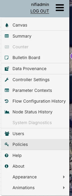

From the NiFi UI you can access the global policies from the NIFi global menu in the upper right corner of UI.

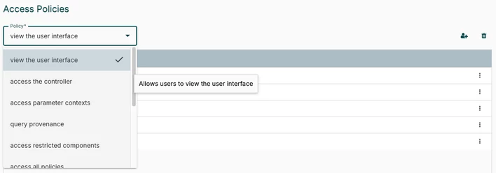

"Policies" will open a new UI, where you can select "view the user interface" fomr the drop down selection:

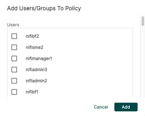

Then you can click on the person icon to the right to authorize additional user identities.
Your list of user will be different.  What is important to note is NiFi user and group identities are case sensitive and must match exactly.  So the exact user identity shown in the nifi-user.log is the one that needs to be added to the "view the user interface" policy.

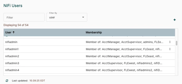

If this user is not in the list, you must first add that user identity and then you will be able to authorize it.  This can be done if you are using the managed-authorizer with the file-user-group-provider.  If so, you can access "Users" from the NiFi global menu to open the NiFi Users UI:
From there you can use the "+" icon to the right to add a new user identity. Remember that user identity string must match exactly case sensitive with what is shown in nifi-user.log; otherwise, it will be treated asa different user.
