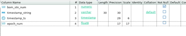

The database has columns for storing the timestamp in string, timestamp and as an epoch number.

This is inserted into the table with the timestamp microsecond precision truncated.
