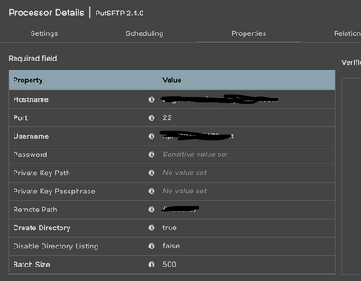

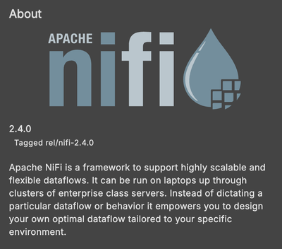

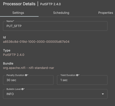

What version of Apache NIFi is being used?

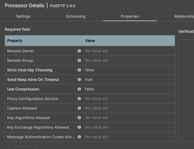

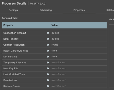

How is your PutSFPT processor configured?

nisaar
nisaarAuthor
Gold ⭐️
April 27, 2026
@MattWho
This is the only log I get under Bulletin Board
net.schmizz.sshj.transport.TransportException: Server closed connection during identification exchange
Thank you!
