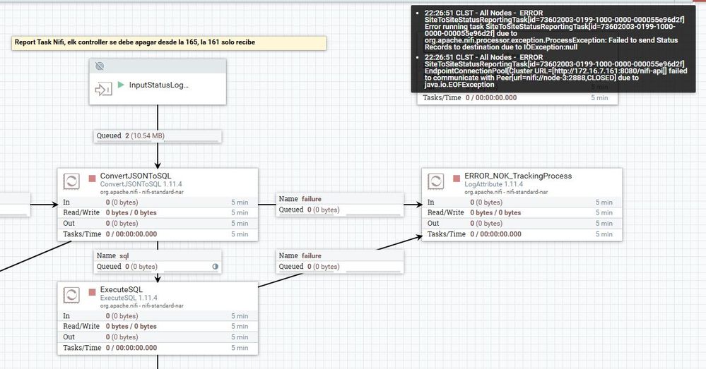

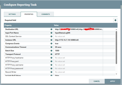

Please, I have a couple of questions. To put it in context, I need to capture only the flows that are running with errors, and I'm wondering how or what the recommended configuration would be for configuring the Site-to-Site Status Reporting Task controller for a 3-node cluster. As it is, it generates a lot of error messages and fills up my disk. Therefore, I want to suppress those messages with the correct configuration.

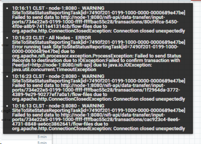

node-1:8080SiteToSiteStatusReportingTask[id=743817f2-0199-1000-0000-000026cab202] EndpointConnectionPool[Cluster URL=[http://172.16.7.xxx:8080/nifi-api]] failed to communicate with Peer[url=nifi://node-3:2888,CLOSED] due to java.io.EOFException
node-2:8080SiteToSiteStatusReportingTask[id=743817f2-0199-1000-0000-000026cab202] EndpointConnectionPool[Cluster URL=[http://172.16.7.xxx:8080/nifi-api]] failed to communicate with Peer[url=nifi://node-3:2888,CLOSED] due to java.io.EOFException
All NodesSiteToSiteStatusReportingTask[id=743817f2-0199-1000-0000-000026cab202] Error running task SiteToSiteStatusReportingTask[id=743817f2-0199-1000-0000-000026cab202] due to org.apache.nifi.processor.exception.ProcessException: Failed to send Status Records to destination due to IOException:null

The two outputs you shared are form two different Site-To-Site Reporting tasks.
The first you shared is produced by the SiteToSiteBulletinReportingTask.
Additional Details...
The second you shared is produced by the SiteToSiteStatusReportingTask.
Its fields will vary based upon the type of component. Additional Details...
The exceptions you shared are bulletins only and always being reported as issue sending to http://node-1:8080/  node. I see all your other configuration are based off IPs.  Are all you NiFi nodes able to properly resolve "node-1" to the correct IP address?

Back to this, again very very grateful, I made the suggested changes regarding the definition of the s2s urls, Yes, the nodes resolve well by node-1, node-2, node-3, the issue with the s2s messages is that they reach the log and fill up the disk, I have budget limitations in technology, I can not allow it to increase, then my nifi falls by disk, therefore I have maintenance shells that run every day to maintain disk usage, I checked and indeed the 2 controllers, the s2sbolletin and the s2s status, work for me, they will remain in different tables, I made the changes, I was confused with the formats regarding one with the other, thank you very much Matt
