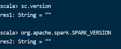

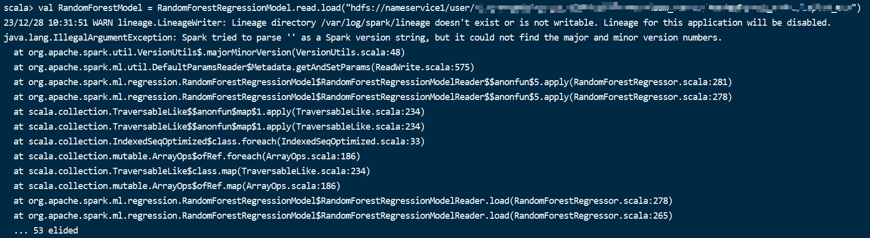

at first, i want to reuse my model in HDFS, but it reported something wrong:
it seems to be because the spark version is not set up correctly, I read the source code and found that spark calls sc.version when it stores the model. However, embarrassingly, the spark2.4.0 that comes with CDH6.3.2 that I use produces the following result: SPARK_VERSION is empty.
I need to use CDH spark to save and read the model, what should I do in this case, thanks very much!

After several days of trying, I studied the source code and found that the package object named package in the spark-core module read the properties file and set SPARK_VERSION. I wrote it as a static version instead of obtaining it through the properties file. Then, I recompiled the spark-core module and replaced it. Finally, it can work!
I know this is just a temporary solution to this problem, and it may be caused by more serious and underlying errors, such as problems with scala dependency packages. I believe this is because there is an exception thrown when the properties file cannot be obtained in the source code.But in reality, the exception does not exist and the properties  file is a real existence. I hope everyone has better insights to share with me. Thanks again for paying attention to this issue! Good luck!
