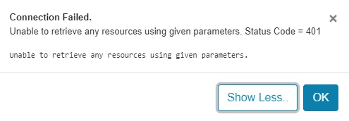

Trying to integrate Apache Nifi with Apache Ranger gives: Unable to retrieve any resources using given parameters. Status Code = 401
I have been trying to integrate Nifi with Apache Ranger. When I manually configure policies in Ranger for Nifi the policies are fetched by Nifi and authorization works fine.  But when I try to define the service definition and test the connection its is giving the following error.

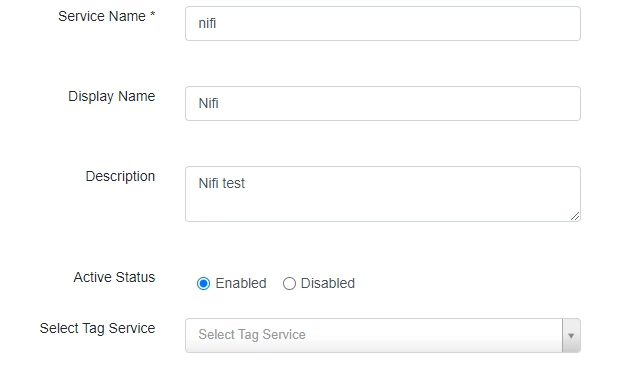

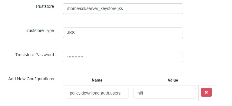

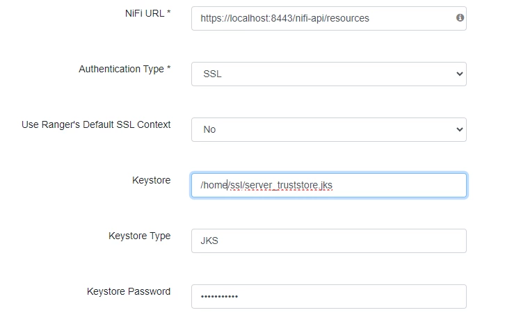

The configuration in service definition is shown below.

Seems odd to me that in the shared Ranger configuration you have configured a truststore where Ranger is expecting a keystore.  Then you have your truststore configured with the keystore instead of truststore.
The Ranger service is attempting to connect to NiFi's /resource  NiFi resource Identifier endpoint in order to obtain an up-to-date list of NIFi Resource Identifiers in order to simplify creating new policies in Ranger for NiFi.  The endpoint requires authorization and NiFi gets its authorization from the policies it downloads from Ranger.  So we have a which comes first, chicken or the egg, scenario here.   You will need to authorize the clientAuth certificate configure in the keystore for READ on the "/resources" NiFi Resource Identifier before Ranger will be able to fetch all the rest of the NiFi resource Identifiers.
Before that is possible, Ranger will need to be able to successfully negiotate a mutualTLS handshake with NiFi.  This does not require that Ranger server is SSL enabled, just that the NiFi service within Ranger is configured with a keystore and truststore capable of facilitating that mutualTLS handshake with the secured NiFi.
Also keep in mind that Ranger service user is executing this client connection to NiFi and thus the keystore and truststore configured must be accessible by the Ranger service user.  The Truststore used in Ranger NiFi service must contain the complete trust chain for all the NiFi cluster node's certificates.  The ClientAuth certificate in the keystore used in the Ranger NiFi service must be trusted by all the NiFi cluster nodes (meanings its complete trust chain must exist in NiFi's truststore configured in the nifi.properties file).

pacman
pacmanAuthor
Gold ⭐️
September 18, 2023
Looks like my issue is with specifying policy.download.auth.users as nifi. I was integrating pluggin following this article. I skipped the step 7
  • Give user and group ownership with nifi process user and set permission 400 to files ranger-nifi-audit.xml and ranger-nifi-security.xml
I tried adding a new user nifi and group nifi in my ubuntu and permission 400 and ownership to nifi user for files ranger-nifi-audit.xml and ranger-nifi-security.xml. But still its throwing 401.
Update:
I modified the bootstrap.conf file in Nifi to update run.as  property to nifi and other users as well. But still there isn't any effect.
@MattWho  @bbende  any thoughts on this?

@MattWho  the 401 issue was a silly issue with specifying truststore instead of keystore and viceversa. But now it is throwing SSL Handshake exeception as below.
Since both nifi and ranger is running on my local machine I configured the same truststore and keystore for both.
Update:
Not sure what is wrong with the SSL certs I created using openSSL, but when I create certifcates with nifi tool kit the exception has gone. Now its throwing 403.

@pacman
The "unable to find valid certificate path to request target" is caused when trust can not be established in the TLS handshake.  This is the result of missing trusted cert entry(s) in the truststore (missing or incomplete trust chain).   When you used the toolkit to create your certficates, it also built the corresponding truststore with the required trust chain.
The HTTP 403 exception indicated not authorized while the 401 indicated failed authentication.
Authentication was determined through the mutualTLS handshake between the clientAuth certificate presented from the keystore configured in Ranger and serverAuth certificate presented by NiFi.   The DN from the clientAuth certificate is used as the user identity in the authentication (keep in mind that during authentication the final user identity is determined after evaluating the user identity returned during authentication against any configured Identity mapping patterns configured in the nifi.properties file.
If you inspect the nifi-user.log, you should see attempt to access the .../resources NiFi endpoint (This is endpoint where Ranger is trying to fetch the list of NiFi resource identifiers).  In that nifi-user.log you will see the actual post authentication user identity being used (full certificate DN or some valued mapped from that full DN).  This is where my early response about needing to authorize the ranger clientAuth certificate user identity in Ranger manually against the "/resources" NiFi resource Identifier is needed.
So you'll need to make sure the exact user identity from the nifi-user.log is added as a user in Ranger and added to a NiFi service policy in ranger giving that user authorization for "/resources".  Once NiFi downloads the updated policy json from Ranger, Ranger NiFi service client will now be authorized to fetch all NiFi Resource Identifiers from the /resources endpoint.
