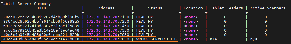

Two UUID tablet server after restart where the wal directory was lost.
We faced the problem on our production kudu cluster. The hard disk with wal catalog was failed on the tablet server. We install new disk and clear data directory according to Kudu documentation https://kudu.apache.org/docs/administration.html#rebuilding_kudu . After starting the failing tablet server we have seen that kudu ksck displayed two instance tablet server for one server with different UUID. One of this server had status "WRONG SERVER_UUID".
Why may the error occure? Are there any ways to avoid it? Is there way to solve the problem without restarting master server?
Also found the command "kudu tserver unregister" for removing tablet server with wrong UUID but we hadn't found this step in documentation.

5.Execute <kudu cluster ksck kudu-master-1:7051,kudu-master-2:7151,kudu-master-3:7251>. We get two UUID tablet server. One is in the status "WRONG SERVER_UUID".

Its Because of this Disk change where UUID of this TS was different but after change of WAL it created new one hence you seeing the wrong_server_UUID , simple restart of this TS will fix the issue in most of cases if not then please rebuild this TS from scratch while deleting the data and wal dir of this one it will solve the issue
Note: Only proceed with rebuild if you have RF=3 in the cluster otherwise it will be a dataloss scenario
