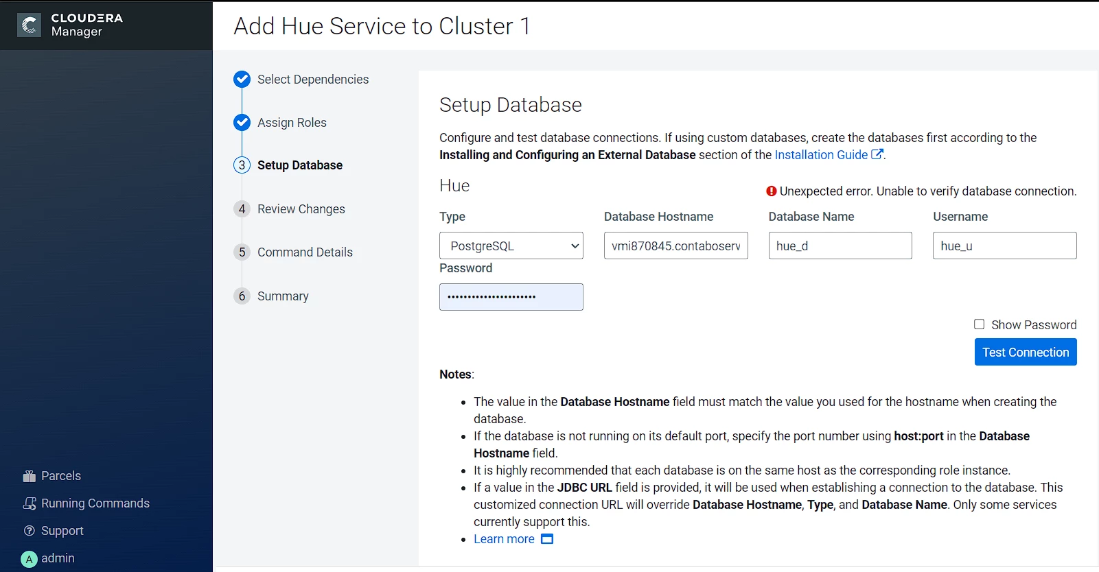

Unable to connect Hue to it's database
I am unable to complete hue installation due to the following error
Unexpected error: Unable to verify database connection
#Hue

This looks like a driver issue  can you run  the below it would affect your ambari server
Spoiler
ambari-server setup --jdbc-db=postgres --jdbc-driver=/path/to/postgres/postgresql.jar
Then retry the earlier steps or  just  create  HUE database manually then with the  credentials connect through the HUE service setup
Hey @Shelton
First of all thank you for your feedback, but i don't think this is the problem because i have already hive metastore and ranger database running on the same postgres connection!
Master Mentor
@lysConsulting
Are you using embedded DB? if not can you log in to the HUE database from the CLI?
