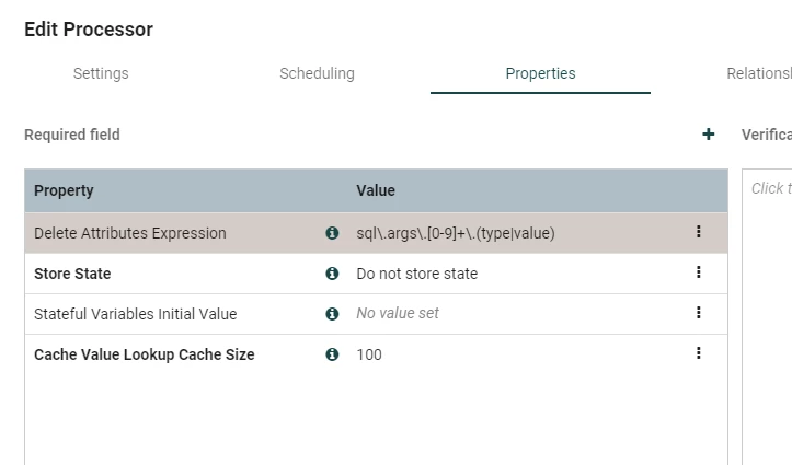

1- One way to mitigate this issue is by adding an UpdateAttribute before the final PutSQL to delete all sql placeholder arguments with the following Regix in the "Delete Attribute Expression" property:
sql\.args\.[0-9]+\.(type|value)

For reference, I tried solution #1 where I added an UpdateAttribute processor and deleted any references to SQL attributes. That did it.
Thanks!
