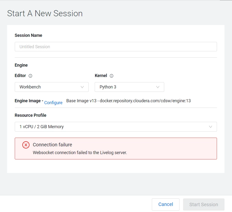

Websocket connection failed to the Livelog server.
I have installed CDSW in my cluster and created a project. But while launching the session I see the following error.
I'm adding the details of 'cdsw status' here,
[root@edge ~]# cdsw status
Sending detailed logs to [/tmp/cdsw_status_mrI87T.log] ...

Cloudera Data Science Workbench is ready!
Is it some issue with the live-log cleaner pod or something else?
