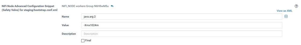

@GKrishan
You want to be very careful when setting safety valve in CM to override existing default property values in NiFi files.
@wengelbrecht screenshot shows creating a safety valve that would override "java.arg.2" in the NiFi bootstrap.conf file with a new value of "Xmx1024m".  The problem here is that "java.arg.2" is used to set Xms while "java.arg.3" is used to set Xmx.  So you would end up with two properties defining Xmx and missing the property for Xms.

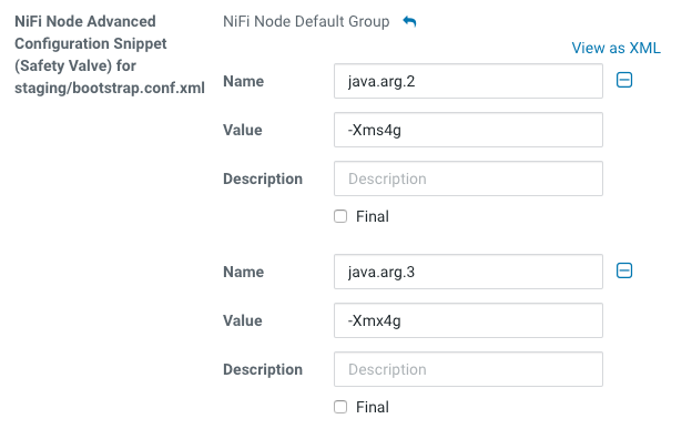

Here is an example setting override safety valves in CM for both Xms and Xmx:

In CM, the bootstrap file is auto generated when you start NiFi, so it is not really something you can edit.
However you can set the same parameters through name=value pairs as Java args in CM:

@GKrishan
