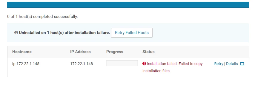

cdh6.1.1 Error installing CM Agent "Installation failed. Failed to copy installation files."
when i install cm agent using cloudera manager,got "Installation failed. Failed to copy installation files."
click the ditails:
Failed to copy installation files. View
/tmp/scm_prepare_node.SkukORUR
Could not verify key bundle
check the log

i tryed
wget https://archive.cloudera.com/cm6/6.1.1/ubuntu1604/apt/archive.key ;apt-key add archive.key
did not work
