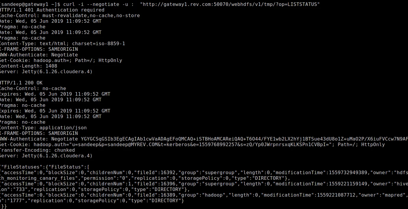

1. Webhdfs: curl with Kerberos enabled  with port  50070 I am able to list status

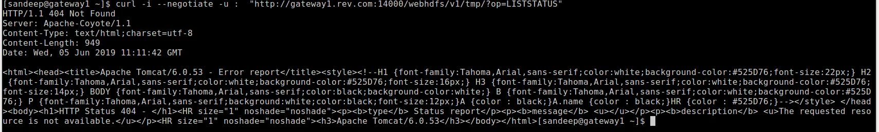

2. HTTPFS: curl with kerberos enabled with port 14000, I am getting 404 not found.
Both curl commands file path location is the same.
Can anyone have this issue?

Hi @Reavidence ,
Can you please confirm that httpfs is up and running? Please check the log to confirm that it is running fine. The default log location is:
var/log/hadoop-httpfs/hadoop-cmf-<hdfs-service-name>-HTTPFS-gateway1.rev.com.log.out
Maybe also try to restart httpfs and see if that helps.

I restarted but it's in shutdown state.
