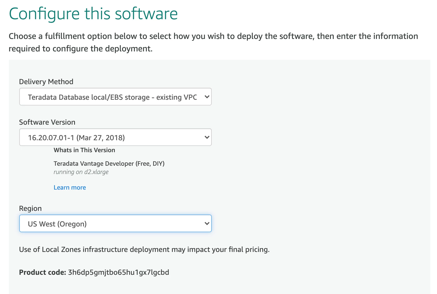

  1. Once the assets are created, go to Teradata Vantage Developer and select your configuration (make sure you select the same region as the assets you created):

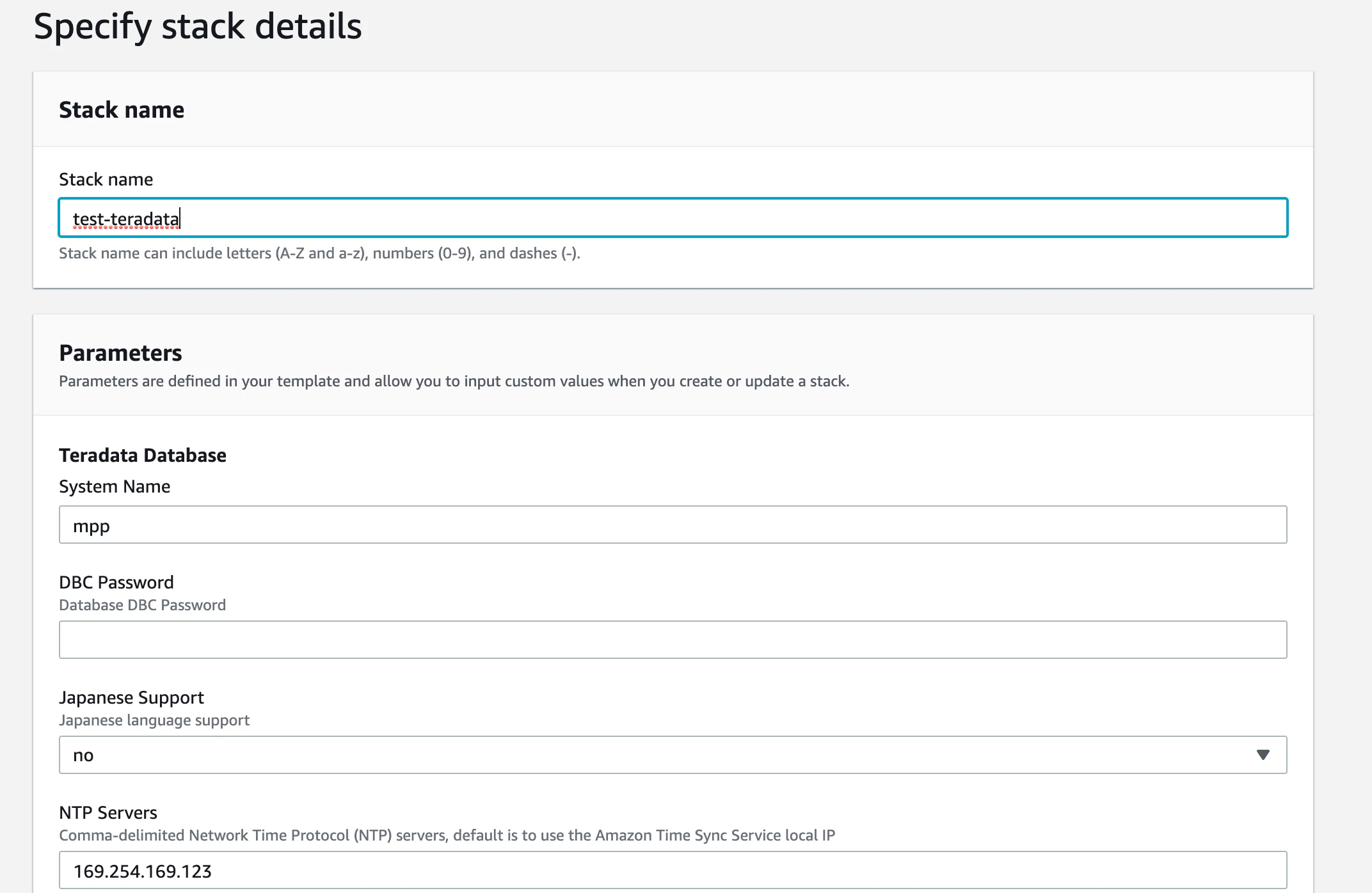

  2. From this configuration, launch the CloudFormation template and fill the parameters with the AWS assets you created:

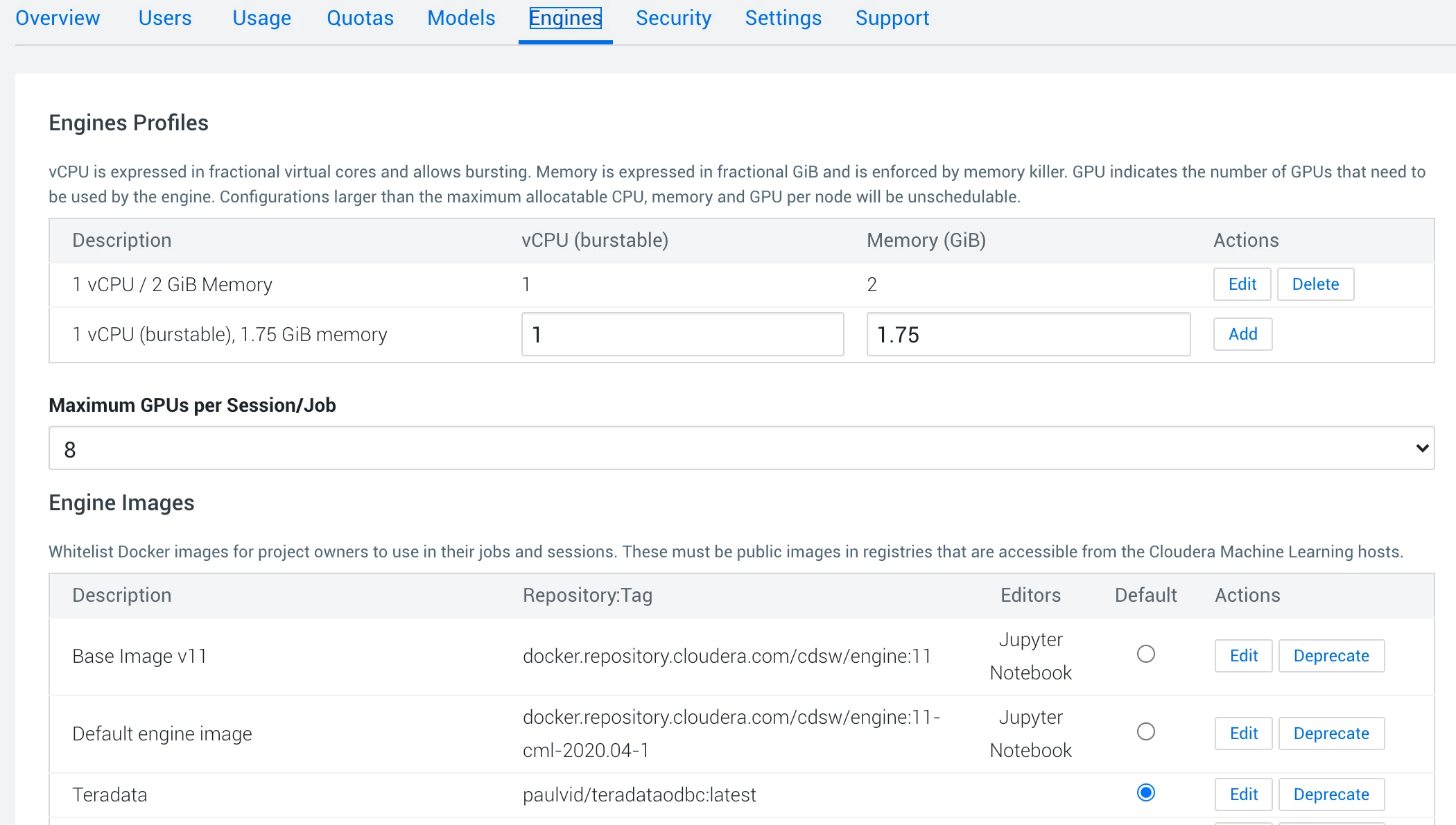

  2. Finally, connect to CML and add this new engine:

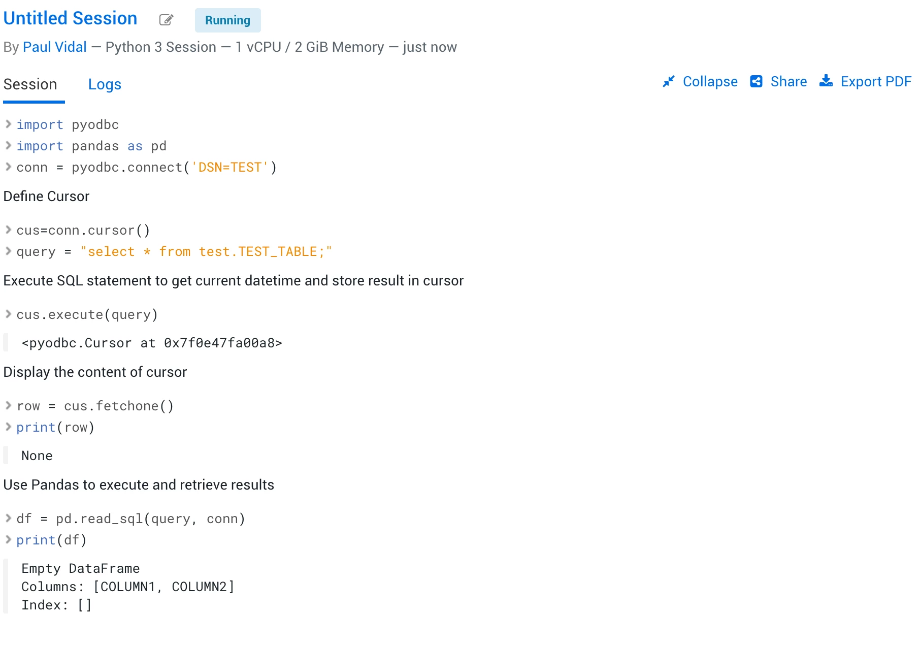

  5. Finally, you can run the following code to test:
    import pyodbc
    import pandas as pd
    conn = pyodbc.connect('DSN=TEST')
    # Define Cursor
    cus=conn.cursor()
    query = "select * from test.TEST_TABLE;"
    # Execute SQL statement to get current datetime and store result in cursor
    cus.execute(query)
    # Display the content of cursor
    row = cus.fetchone()
    print(row)
    # Use Pandas to execute and retrieve results
    df = pd.read_sql(query, conn)
    print(df)
The output in the workbench should look something like the following:
