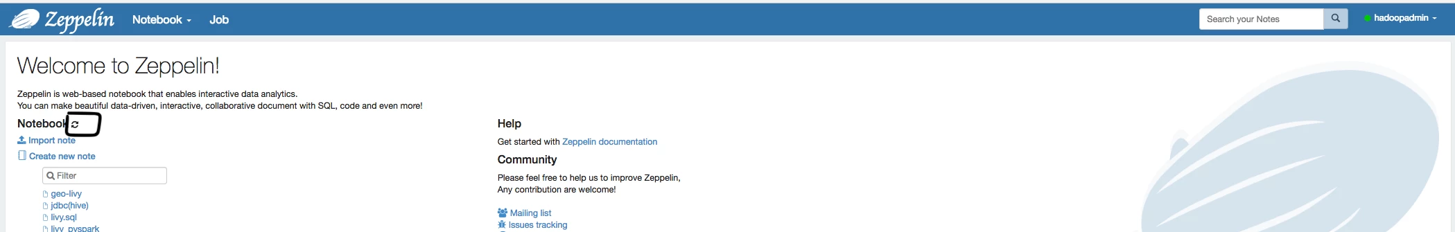

Adding multiple instances of zeppelin is not exposed in UI because fo few limitations. (No HA support without a external tool, notebook created in one instance of zeppelin will not be visible until you manually re-load the notebooks or restart the instance are the few limitations I am aware off)
