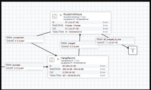

If you are having all files in same format, then mergecontent is only option.
One simple example that may give you hint to solve your problem.

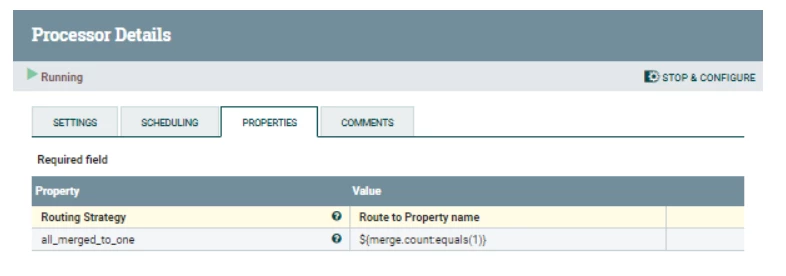

Use the RouteonAttribute processor and connect to merger record processor
On the  RouteonAttribute  processor use the configuration ${merge.count:equals(1)}
let say if single file then it will end. else it will go to mergecontent processor and merge all files.
