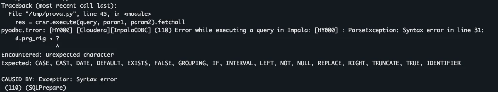

I tried to submit a query with params via ODBC to Impala. Thi is my code:

But this is the output:
I installed this driver: ClouderaImpalaODBC-2.7.1.1009-1.x86_64.rpm
If I try whit simple query, without subqueries, it works.
Any suggestions?

@disoardi Parametric queries do only work if the "UseNativeQuery" option is set to 0, this is the default (but you might have it set to 1 in the DSN configuration).
Yo could try connecting with:
crsr = pyodbc.connect('DSN=impala;UseNativeQuery=0', autocommit=True).cursor()
See page 84 of the "Cloudera ODBC Connector for Apache Impala Installation and Configuration Guide" for the full description of this option.

The error message shows that Impala gets the query with question marks in it, which is not good, as Impala itself doesn't supports prepared statements or query parameters. All of this functionality should be done in the ODBC driver.
You've written that a simple query without subquery works. Does the simple query works with or without parameter substitution?
Since the whole prepared statement/query substitution is don by the ODBC driver, and not by Impala, you would get no performance gains from using it. So I believe this only useful if you are porting some existing code/queries to use Impala.
You can just use a python f-string or the .format() function to do the parameter substitution by yourself in your code, it won't hurt performance.

The simple query, without subqueries, with params works.
For example:
SELECT * FROM target_test.test2 where id = ?;
 About the support of params in the ODBC driver for impala I found this: https://community.cloudera.com/t5/Support-Questions/Unable-to-pass-parameter-to-Impala-from-SSRS/m-p/65620/highlight/false#M4261
Quickly the ODBC driver for impala supports the standard SQLBindParameter() API to subsitute ? in the query text with parameters.
but this seems not to work for complex queries.

I would try if replacing the sub-queries with 'WITH' statements would help. Maybe the query is just too complex for this query-rewrite/parameter substitution engine n the ODBC driver.
If that not helps, there are some logging options for the driver, I would use those to see if they give any useful information what is happening inside the driver.

I tried but not works. The complet test below:

the simple query, with parameters, works, others do not

Hi-
If you are using the latest ODBC and seeing this issue, then this could be hitting an ODBC driver 'corner case' bug. Please open a ticket with Cloudera Support, and we will take it further to the Driver Team.
