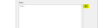

You can use an expression incited of a query.
in the expression ,
your query should be something like this.
=" SELECT A.COL1 , A. COL2 FROM schema.tableName A WHERE A.COL1 = '" & Parameters!parameterName.Value & "'    "
Notice the Quotation marks besides the parameter ( " , '  ) and equal ( = ) sign at the beginning
You should create fields manually( Use query designer without parameters and let SSRS do the Refresh Fields task)
