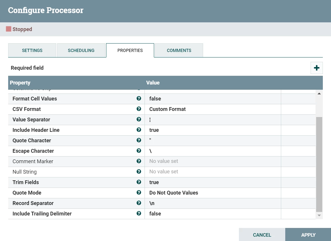

Stefi
StefiAuthor
Silver ⭐️⭐️
Jun 18, 2021 5:58 PM UTC
Hi @aakulov ,
Thanks for answer.
I just checked and this parameter was set to  false, as you can see at the picture. When i use a regular pipe | the csv file is ok, but when when I use broken pipe, I get ? as separator between fields in one record, instead of ¦
Translate
