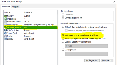

Thanks for your reply. I did the following this it worked for me.
1) Stopped the Ambari and Postgresql database
[root@centos ~]# ambari-server stop Using python /usr/bin/python2.6 Stopping ambari-server Ambari Server stopped [root@centos ~]# service postgresql stop Stopping postgresql service: [ OK ] [root@centos ~]#
2) Changed the network setting VM ware from Bridge to NAT
3) Restarted the Network Service
#service network restart
4) Started the Postgresql database
[root@centos ~]# service postgresql start Starting postgresql service: [ OK ]
5) Stared the Ambari-service
[root@centos ~]# ambari-server stop Using python /usr/bin/python2.6 Starting ambari-server
After complete this mine Ambari Web Interface was working fine.
