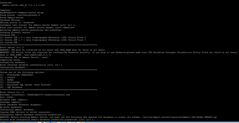

You are mixing couple of things here.
1) Cleanup https://community.hortonworks.com/content/idea/138/cleanup-scripts-to-remove-old-hdp-bits.html
2) ambari-server setup looks fine...as per the screenshot
whats the exact issue now?

@rbalam your Ambari installation looks good exit code 0 ,but am puzzled . can you copy and paste in here your mysql setup for ambari steps?
Expert Contributor
@Geoffrey Shelton Okot
please see the attached screen shot of my MySQL setup for ambari
