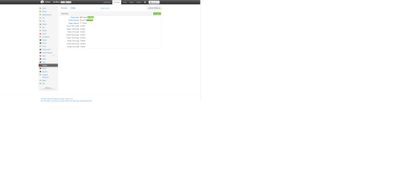

Hello friends, I have down loaded Hortonworks sandbox 2.5 to learn more about Apache Atlas. After I start VM and trying to start Atlas/Ranger in Ambari I am getting error as in attached log and my services are not getting started. Can you please guide me trouble shoot this issue?

Also, I can see that you have maintenance mode turned on ambari-infra component, any specific reason? This actually does not run the service check and you will not able to know its status. My recommendation is to turn-off the maintenance mode on ambari-infra and restart the service. Once this service is up and running - Atlas and Ranger should come up properly. Let me know if it works.

Hi Ayub, thanks a lot for your help. It worked 🙂
