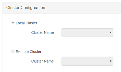

In a freshly installed Ambari server most views did not point to a cluster name (the cluster name was empty). This was strange itself, but even more disappointing was the fact that also I was not able to modify Hive view. The pop came with the message:
Can't save settings. Server error
which was not very informative...

Created on 12-15-2016 03:36 PM - edited 08-18-2019 05:33 AM
I am using Ambari 2.4, the one currently available for download.
Log file "/var/log/ambari-server/hive-view/hive-view.log is empty.
The image below shows that no cluster was assigned to the view (this view was created automatically). This was true for all views, not only Hive view.
However only Hive view did not allow me to assign the cluster. Any attempt to modify the view throws the pop up shown below

Also it was not possible to delete this view
