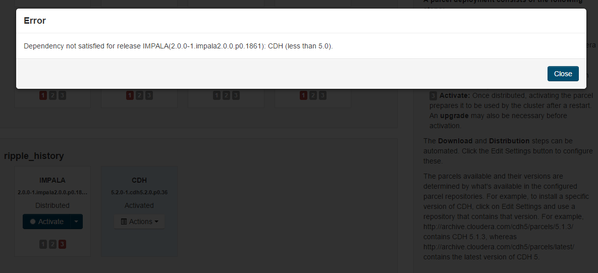

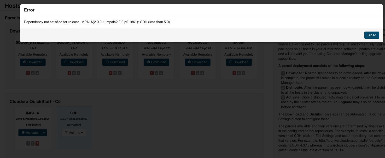

Explorer
als had problem upgrading from 5.1.0
cjnoyes and scratch28, could each of you please post a screenshot of the error you are seeing?
Regards,
Gautam Gopalakrishnan
Contributor
Sure here you go
Impala2 CDH 5.2 but check says otherwise
I don't see a screenshot in the post, just a yellow triangle. Could you put it up on a webhost somewhere (imgur, photobucket etc) and paste a link here?
