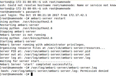

Got your Point regarding Ambari host.
my ambari URL is : namenode:8080 so i log into @namenode and wrie the command " ambari-server restart"
this command successfully run and it shows "Ambari Server Run Successfully".
when i try to get the log by writing below command :
/var/log/ambari-server/ambari-server.log
it gives me message : "Permission Denied"
see the attached image

Master Mentor
@Mudassar Hussain
Regarding the
This is because you need to specify the commands like "vi" , "cat" or "less" before the filename as following:
# less /var/log/ambari-server/ambari-server.log
# vi /var/log/ambari-server/ambari-server.log
# cat /var/log/ambari-server/ambari-server.log
