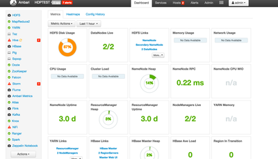

@Pradeep kumar Let's focus on ambari.
Thats my ambari dashboard...You need to click
http://ambariserver:8080
replace ambariserver with your ambari host and then you will have full control on cluster start and stop
admin/admin is default login

Hi Naveen,
I think you have not understood my question correctly. I am able to access Ambari Dashboard. I am able to see all nodes in my cluster and all nodes are working fine. Even the MapReduce Service is show as working fine (green). The question is, how do I ensure that hadoop is working fine? how do I do a smoke test to see if hadoop is working? This is where my problem started. On the command prompt if I type jps command, it doesn't detect it as a valid command. So the problem is about how to check if hadoop daemons are running and hadoop system in place?
