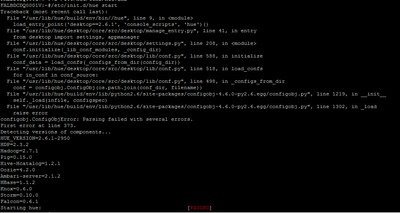

I installed and configured Hue using the following URL on the edge node of this cluster but when I try to start it for the first time I see some errors.

You have duplicated entries in your hue.ini for RM.

Hue error while starting it for the first time after the install

@rbalam It has to do with the python. It looks like you are using 2.6.1
Verify that you have at least Python 2.6.6 or higher installed.

Thanks @rbalam!! Please verify hue.ini as looks like there are several errors because of hue.ini
