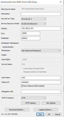

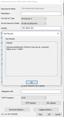

I'm testing the ODBC but the test fails, don't know what wrong. Also what username and password used to connect to hive server? somebody please help!!!

Can you check on:
- Incorrect port (Are you using binary or hhtp mode?)
- The Hiveserver2 availability (is it up and running?)
Also root as user to connect to hive seems odd... Can you attempt hive user and its password?

Created 08-29-2018 09:32 PM
Was using http mode before updating it to binary and setting port to 10000 worked!!!
Thank you
