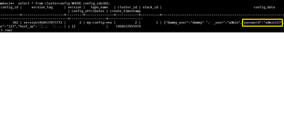

Ambari stores the service configuration in postgresql DB. My service has password property as a part of configuration file, i want it to be stored in enrypted/encoded form.Is there any way to do that? I have checked in Ambari DB but it stored in plain text for my service. How Hive & oozie stored their DB credential ?

I am using ambari 2.3.2 , but still configuration property for my custom service gets stored in plain text format.
I tried with "ambari-server setup-security" but it encrypted the postgres db password. Not my custom service user entered password.

@Shashank Rai Not currently supported but planned for 3.0: See https://issues.apache.org/jira/browse/AMBARI-19109
