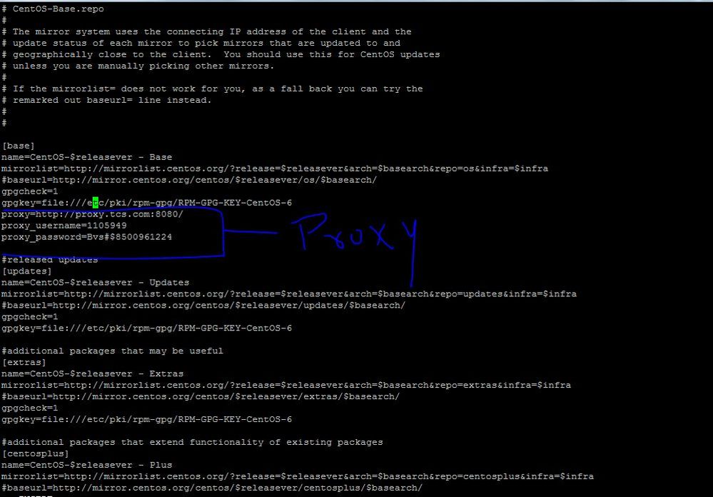

Please see the snapshot - proxy.jpg .The setting is under /etc/yum.repos.d and edited the vi CentOS-Base.repo

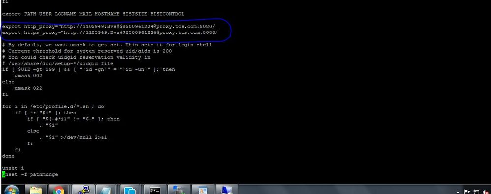

Also under vi etc/profile the proxy is given as (Please check the etc_profile )
@ASHISH Rastogi There are two problems with your etc/profile configuration.
The first is you have a set of double quotes on each line that are not closed.
The second is that you have a trailing / at the end of the line.
Change the end of both of the lines in your etc/profile configuration from:
8080/
to
8080"
Then log out, and log back in again via ssh, and retry the wget command.
