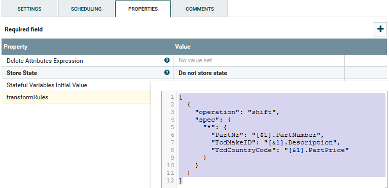

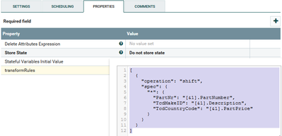

I create a POC with an UpdateAttribute that is creating the attribute 'transformRules' with the value:
[{"operation":"shift","spec":{"*":{"PartNr":"[&1].PartNumber","TcdMakeID":"[&1].Description","TcdCountryCode":"[&1].PartPrice"}}}]

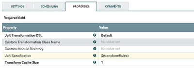

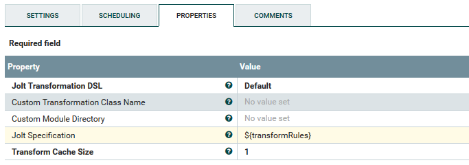

Then I have a JoltTransformJSON processor that uses this attribute as Jolt Specification, and the components looks like this:
ideas about how can I solve this issue?
