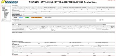

@Nilesh From the resource manager UI i see there are no "Active Nodes" running and hence the "Total Memory" in UI is displaying 0.
Can you check if your node managers are UP and communicating to RM.
