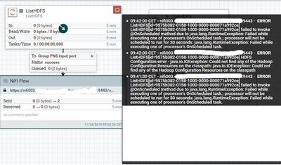

Created on 11-24-2016 08:47 AM - edited 08-19-2019 03:42 AM
I got a dataflow with listHDFS and RPG but i don't know explain this error :
Created 11-24-2016 09:03 AM
The second error message on bulletin indicating that any Hadoop configuration file could not be found.
Please check file path configured at 'Hadoop Configuration Resources' of ListHDFS. It should point at core-site.xml and hdfs-site.xml, and should be accessible by the user running NiFi.
Created 11-25-2016 09:17 AM
@kkawamura : the second error is very clear. I'll talked about first message error.
Created 11-25-2016 11:57 AM
Hi @mayki wogno
The first error message was also written by the same error with the second error message. The processor reported the error twice, because it logged an error message when the ListHDFS processor caught the exception, then re-throw it, and NiFi framework caught the exception and logged another error message.
When NiFi framework catches an exception thrown by a processor, it yields the processor for the amount of time specified by 'Yield Duration'.
Once the processor successfully accesses core-site.xml and hdfs-site.xml, both error messages will be cleared.
