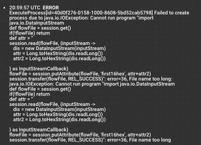

Need to convert a hex file to another format using HDF
I have a couple of rather large hex files I need to convert to another format with the intention of then stripping out certain attributes and storing results in SQL Server and/or Hive. The files are 12.7 MB and 3.3 MB. When I use the code from this HCC answer https://community.hortonworks.com/questions/60597/hexdump-nifi-processor-nifi-hexdump-processor.html
import java.io.DataInputStream

in an ExecuteProcess I get a "File too large" error.

Scott,
Use ExecuteScript processor, as mentioned in the article. Looks like you are putting an embedded script into ExecuteProcess, which is meant to invoke OS shell commands, hence the error.

Can you share a stack trace / error log from logs/nifi-app.log? I'm curious to see what part of the code gives a "File too large" error.
I apologize. The actual error is "File name is too long". The name of the file is COWFILE1.DAT and COWFILE1.ARC.
Here is the repeating error in nifi-app.log.nifi-app.txt
Scott,
Thanks @Andrew Grande! That worked! I feel like a noob 🙂 but appreciate all the help!
