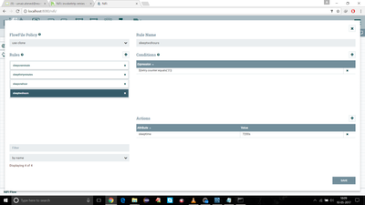

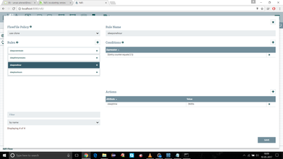

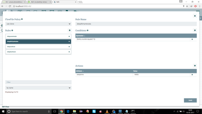

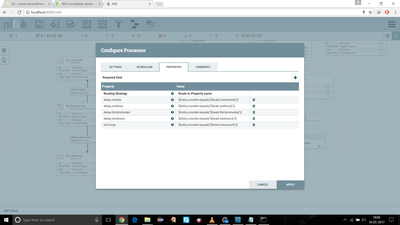

Here is the configuration of the RouteOnAttribute processor15269-screenshot-9.png
